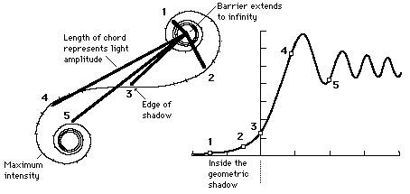

It's not. See for example edge diffraction. (picture here)

What are the units on the x-axis in the graph of the link? I'm assuming the units are in wavelengths of the light, but does each tick mark mean 1/100 of a wavelength, 1/10 of a wavelength, etc?
Also, can one extend this to a finite plane to get the diffraction pattern around a barrier? For example in the link, the half-plane is in the negative y-axis. If you put the half-plane on the positive y-axis instead, and superpose the result with the half-plane in the negative y-axis, then would this be the diffraction pattern of an infinitisemal point situated at the origin?
Also, I'm not understanding the photograph of the diffraction pattern of the laser in your second link. It looks like the screen was photographed parallel to the screen, so that the pattern is on the horizon. Is this the case? So by machined metal edge, I assume this is the half-plane of a metal sheet, and black band on the bottom of the picture is the geometric shadow region that's blocked by the half-plane, and the top of the picture will be very bright as it's the geometric light region? Also, why does it matter that it's metal?
Dealing with Fresnel diffraction and the Cornu spiral is a bit messy. It's been a while since I worked through an example in detail myself. Maybe the following pages that are linked to that page will help:

The treatment on Hyperphysics is pretty basic and doesn't have very many examples. If you Google on "Fresnel diffraction" you should be able to find more.
It matches the diagram at the upper right corner of the first link. The screen is the vertical dotted line at the right side of that diagram. The source is on the left side.
It's easier to get a sharp straight edge with metal than with (say) cardboard. Brand-new razor blades are good for this.

Thanks. I think the fact that the oscillations get smaller as you go up the screen, makes it look like the bands are equal-sized but the camera is shooting parallel (and not perpendicular) to the screen, so that bands at the very top become foreshortened as the mind interprets them as close to the horizon where everything is spaced closer together due to foreshortening.
To me the picture initially looked just like that, with the very top bands serving as sort of a horizon. But the top bands really are smaller and this is a two dimensional photo and not a 3 dimensional one. I think they could have prevented this by having the half-plane the other way, on the top instead of the bottom.

For a very wide aperture, you get two edge-diffraction patterns like the ones illustrated by the links in my previous posts, facing each other so to speak.
As the aperture becomes narrower, the two edge-diffraction patterns overlap and the result becomes complicated. You can't simply add the patterns because they "interfere" with each other.
As the aperture becomes very narrow you get the simple Fraunhofer single-slit pattern.
