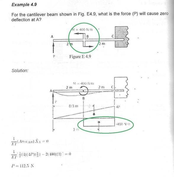

why does the moment -400Nm only act at region B and C?
Why it doesn't act from A to C?
http://imgur.com/a/5tfCg
As we can see from figure, there's moment 400Nm on the beam at B at the top part and also the below part...
notes here

The moment at B is called a couple. It acts on the beam as a whole. It's applied at point B, so naturally it acts there. The beam is fixed at point C, so a moment reaction will develop there to keep the beam in static equilibrium. This is why the moment diagram looks the way it does.
Likes chetzread
so, the moment 400Nm at B has anticlokwise direction, it cause the beam at B to become concave downwards, at c, the moment is clockwise , so , the beam at c will also concave downward , so, at both B and C the moment is negative, am i right?
Thus, moment anticlokwise = moment clockwise , beam in equlibrium?

At B, the couple is CCW and has a positive magnitude.
At C, the reaction must be CW, and the moment there will have a negative magnitude, to ensure that there is no net moment acting on the beam.
If the moment at B is positive, then why it's - 400Nm oat B on the graph?
It's not -400 N-m at B. The diagram is indicating that the reaction moment at C is -400 N-m, so that the net moment becomes zero.
Likes chetzread

The magnitude of the couple is +400 N-m at B.
In order for the beam to remain in equilibrium, the reactive couple at C must be -400 N-m, which is what the diagram indicates to me.

If you look at the moment plot at C, it clearly indicates that the reactive moment there is -400 N-m, which, when added to the moment at B of +400 N-m, equals zero net moment.
Your interpretation of what the plot would look like would require a net change in moment of -800 N-m, which is not supported by the loading of the beam.

The moment diagram doesn't plot discrete values of BM in isolation, like you apparently want to do.
At point B, the moment goes from 0 to +400 N-m, which is why there is a jump at this location.
The moment remains constant at +400 N-m from point B to point C, where the reactive moment of -400 N-m is added to the +400 N-m, to bring the net moment back to zero.
You should review how shear force and bending moment values are plotted for regular beam problems.

The "positive" side is the side which is shown by the author on the diagram. Certain allowances must be made so that the two diagrams don't overlap, which would make things even more confusing.

The beam is fixed at C, so a reactive moment is supported there. The beam is free at A.

There is no moment applied at point A, so there won't be one showing up on any moment diagram.
There is a moment applied at point B, which is why the moment diagram starts there.

Do you mean that since the moment at B is positive 400Nm, so the moment -400Nm must be restricted at any points along beam BC to keep it in equilibrium?
  • #38
  • #39
SteamKing said:
It's not clear what you mean here.
it it because of the reaction moment and moment causes the part of beam to become concave downwards, so bending moment is negative?
