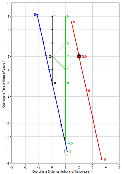

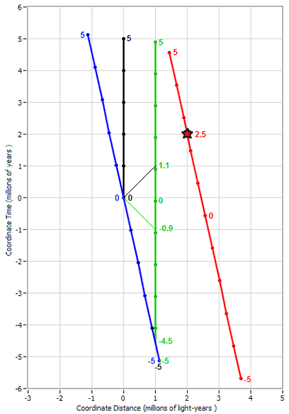

My new question is quite connected to the famous Andromeda paradox. So it's stated that the Andromeda is far away and moving towards the galaxy will cause the observer to have the distant future of Andromeda as his present, in his reference frame (of course future compared to what the stationary observer considers present). So my question is, if we consider a third observer, which is also heading towards Andromeda with the same velocity as the previously mentioned one, but is much more close to Andromeda than the other one, will he consider the same event that the previously one mentioned as his present or will it be also the future one, but one that happened before the event that the observer that is more distant considers present. To sum up, what role does distance to the event play in defining what happens relative to an observer, if they are both having the same velocity, but one is much closer to the event?

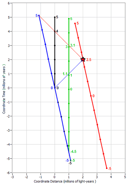

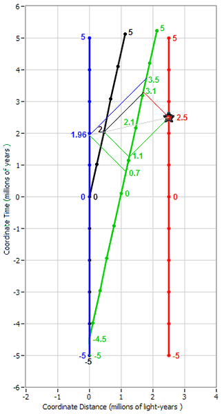

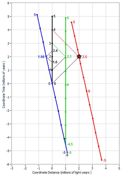

Here are a couple of diagrams, again, like you asked for, showing an example of your scenario. Earth is the thick blue line and Andromeda is the thick red line. I show a star exploding at 2.5 million years in the mutual Earth/Andromeda rest frame. Two observers are moving toward Andromeda at 22% of the speed of light shown in black and green. The dots show the Proper Times for each object/observer. The bottom dots are time zero and the top dots are time five million years. You have to count between them to see the times for the other dots.
The thin blue line represents a radar signal going from the Earth and the black observer at their time zero. It also represents a radar signal going from the green observer at his time of one million years. The return echo from the exploding star is shown as the thin red line. It is received by the green observer at his time of three million years, by the black observer at his time of four million years and by the Earth at its time of five million years:
Although the above diagram shows that the star exploded at 2.5 million years, Earth has no awareness of this until its time reaches 5 million years. It can use the radar signals as I describe in your other thread to establish that Andromeda was 2.5 million light-years away at the time of the exploding star and that it happened at Earth's Proper Time of 2.5 million years.

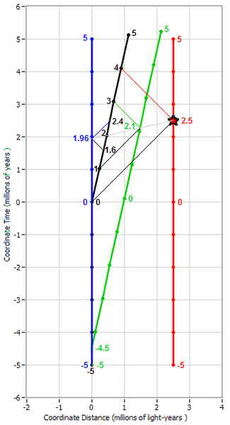

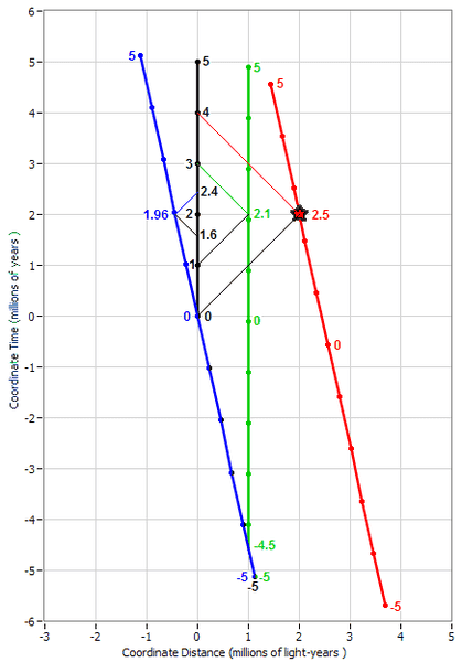

But the black and green observers establish the time and distance to the exploding star differently because they also assume that the radar signals take equal times to get to the star as the echoes take to get back. For example, black sends the radar at his time of zero and receives the echo at his time of 4 million years so he establishes that the star exploded at his time of 2 million years at a distance of 2 million light-years. Green sends his radar signal at his time of 1 million years and receives the echo at his time of 3 million years so he establishes that the star exploded at his time of 2 million years (same as black) at a distance of 1 million light-years.
Now I transform to the mutual rest frame of the black and green observers:
As you can see, all the same radar signals are sent and the echoes received identically according to each object's/observer's clock as in the first diagram but this one is what the black and green observers establish based on their mutual rest frame.
I think maybe your point of confusion is that you didn't realize that we assume that the clocks for the green observer are synchronized with the black observer so that in their mutual rest frame, their Proper Times match the Coordinate Times and that is why they consider the times of distant events to be identical. If we don't do that, we can't meaningfully talk about simultaneity issues.

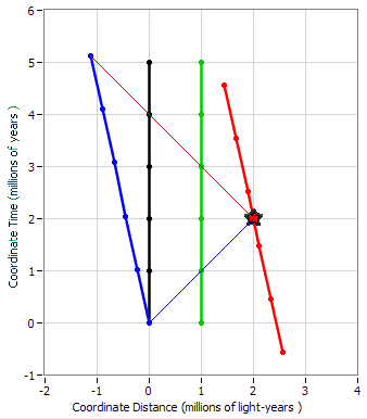

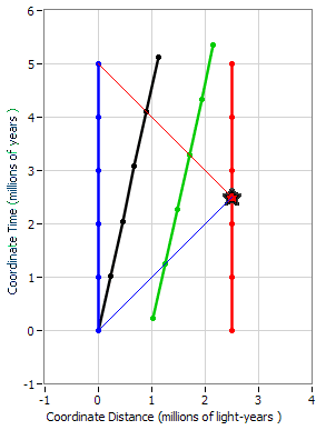

Here is a comparative illustration of the different perceptions of observers E earth, S1 & S2 ships moving toward A Alpha Centauri at .4c and .8c. ( a case that would be possible within a lifetime).
In the E frame, each sends a light signal at the origin, that reflects from an object at A. The coordinates (x,t) for the event are E(4, 4), S1(2.62, 2.62), S2(1.33, 1.33).
The magenta lines are the geometric equivalent of t/gamma (t = round trip time) for each observer. The coordinates are calculated using the SR convention of c*t/2. As speed increases, the observers frame is scaled by 1/gamma.
In the S1 and S2 frames, the observer perceives the universe to be contracted, since A arrives earlier than expected according to their local clock.
The same phenomena apply regardless of distance.

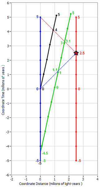

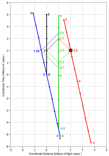

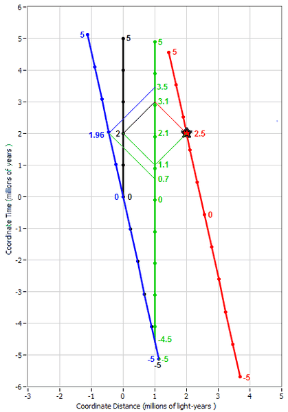

Here is another spacetime diagram that starts prior to the green traveler leaving Earth:
At the beginning of this diagram, it's trivial for the Earth and the two future travelers to synchronize their clocks because they are all inertial, colocated and at rest with each other. But as soon as the green traveler leaves Earth at 22%c his clock immediately goes out of sync with the Earth and the future black traveler. Later on, when the black traveler leaves Earth at 22%c, both travelers are at rest in a mutual Inertial Rest Frame (IRF), but their clocks are not synchronized, even though they are now ticking at the same rate. Here is a spacetime diagram depicting that mutual IRF:
If they wanted to get their clocks synchronized, they would either have to spend a few million years doing it (essentially engaging in radar measurements) or they would have had a prior agreement on how the green traveler would modify his clock to anticipate the black traveler's launch from Earth, in other words, calculate ahead of time how far off the green traveler's clock would be in the coordinate system of the black traveler when he left Earth.
So if we look at either of the above two diagrams and assume both travelers use the radar method to determine the time of the exploding star, the black traveler will establish that it happened at his time of 2 million years at a distance of 2 million light-years, but the green traveler will establish that it happened at his time of 2.1 million years (the average of 1.1 when the radar signal was sent and 3.1 when the radar echo was received) at a distance of 1 million light-years. So they won't agree on where and when the event happened unless they have previously agreed to establish a mutual coordinate system.
By the way, they could have agreed to use their original coordinate system where they synchronized their clocks with Earth and then they would agree that the event of the exploding star happened at the coordinates of 2.5 million years and 2.5 million light-years, just like the first diagram shows.

Furthermore, it sounds like you are saying that even in the mutual rest frame of the two travelers, the Coordinate Times for an event at Andromeda are different for the two travelers and that simply isn't true, is it?

I start with the last diagram from post #15 but I have changed the radar signals to focus in on just the ones sent out by the green observer. Keep in mind that he is continually sending out radar signals in both directions and receiving their echoes along with the images of the other objects/observers but I'm only showing the significant ones. Note that there are no synchronized clocks:
To recap what the green observer does after the scenario is over, he first looks in his log of radar sent/received times and observations of Andromeda that he saw a star explode on Andromeda at his time of 3.1 years and the radar echo that he received simultaneous with that observation was from a radar signal that was sent at 1.1 years. He averages these two numbers and establishes that the event of the star exploding was simultaneous with the event of his clock reading 2.1 years.
Then he looks in his log for the sent/received radar information related to the black observer that also averages to 2.1 years and he finds a signal that was also sent at 1.1 years and received at 3.1 years along with the image of the black's clock reading 2 years and so he establishes that the event of the black's clock reading 2 years was simultaneous with the first two simultaneous events.
Finally, he does the same thing for the Earth data and establishes the event of the Earth's clock reading 1.96 years as simultaneous with the previous three simultaneous events.
So there we have it, green established four events as being simultaneous in the Inertial Reference Frame (IRF) in which he is at rest, using his own clock as the coordinate time, even though there were no other synchronized clocks.
Now I want to repeat the whole process but this time focusing on the black observer who is also racing toward Andromeda. He is at rest in the same IRF as the green observer but since their clocks are not synchronized, he will use his clock for the coordinate time of the IRF:
He observes the star on Andromeda exploding at his time of 4 years which corresponds to a radar signal sent at 0 years so he establishes his time of 2 years as being simultaneous with the event of the star exploding. He also establishes the simultaneous events on Earth as 1.96 years and the green observer as 2.1 years.
If you compare the events that the green observer established as being simultaneous in his rest IRF with the star exploding to the events that the black observer established as being simultaneous in his IRF with the star exploding, you see that they are identical, even though they used different time coordinates based on their own unsynchronized clocks.
Next I want to show the same measurements in the mutual rest frame of the Earth/Andromeda IRF. We start with the green observer's measurements:
All of green's measurements and observations and establishments are the same as they were in his rest IRF.
And here is the same IRF showing black's measurements:
All of black's measurements and observations and establishments are the same as they were in his rest IRF.

...In my previous diagrams in post #12, I picked up the scenario in the Earth/Andromeda rest frame when the black traveler left Earth and I defined that event as the origin of both diagrams. I also assumed that the Proper Times on all three of those clocks was set to the Coordinate Time and I pointed out that the Proper Time on the green traveler was not set to the Coordinate Time of that IRF but rather to the Coordinate Time of the mutual rest frame of both travelers. However, I didn't say how that was done and as a matter of fact, as is often done in scenarios like this, we don't concern ourselves with how clocks get synchronized but there is a required process that must be performed to actually make it happen.
Now I'm going to show how the green traveler can synchronize his clock to the black traveler's clock so that they can both use the same coordinate chart to determine the distances to the event of the exploding star on Andromeda.
NOTE: I just realized that I neglected to add the "million multiplier" to all the units in my comments in post #33. Consider it done.
We start with the second diagram shown in post #15:
The green observer is continually sending radar signals to the black observer and watching for their echoes as well as watching the black observer. As soon as he sees the black observer launch from Earth, he notes the time the corresponding echo was received (1.1 million years) and when it was sent (-0.9 million years). He takes the difference in those two times (1.1+0.9 = 2.0) and divides by 2 (2/2 = 1.0 million years) and establishes how far light travels in that amount of time (1 million light-years). He takes the average of the sent and received times (0.1 million years) and determines that he should set his clock so that it would have read the same as black's clock at that time. Since he has just determined that he is 1 million light-years from black when black's clock was at 0, then he changes his clock from 1.1 million years to 1.0 million years as shown in this diagram:
The green observer also adopts the black observer's position as being at zero, making his own be at 1 million light-years. The green observer continues to send and receive radar signals. Eventually, he sees the star explode at Andromeda and determines that it occurred at the Coordinate Time of 2 million years and at a Coordinate Location of 2 million light-years, just as the black observer determined in post #15.
