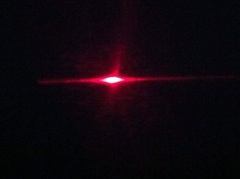

Having performed this experiment, I have gotten clean results. Essentially, a double slit is made by putting an electron beam in the way of a wire with orthogonal polarizers on either side. This destroys the expected interference pattern since the polarized filters "measure" the path of the photons. However if one places a 45 degree polarizer that allows the orthogonal light waves to both pass through, the interference pattern restores. According to the article, this is a "quantum eraser" since the wave nature was destroyed with the perpendicular polarizers and restored afterwards with the 45 degree filter.
This being said, I also understand that the classical Fresnel-Arago laws (link) state that orthogonal waves do not interfere. Wikipedia also mentions that when particle detectors are at the slits, the wave function should collapse. But it also states that this experiment has never been published. Here we have an experiment that places a "detector" at the slits, and as far as Scientific American says, it has collapsed and even restored the wave function. Now, I can only think of 2 conclusions to this:
1) The Fresnel-Arago Laws were a precursor to quantum mechanics and there is no interference because the information has been leaked into the outside environment
2) This is purely a classical experiment and can be explained as such
Is this experiment just a demonstration of classical optics or is there actually a quantum nature to this? I also wonder if Fresnel and Arago had an explanation to the nature of orthogonal light waves, or if the quantum mechanical wave collapse due to observation is the only reason. Does anybody have information on this?

Thank you everybody for the input. I think I have a bearing of what all of this means now.
When I had orthogonal filters on each slit, the result looked very much like the single slit experiment. The light extended outwards horizontally, but no interference was present. Does this mean both waves are spreading out--but not interfering with each other--on the same spot?

So why am I getting a wave pattern (two waves that don't interfere) rather than two sections of light?
Which wave pattern?
mfb said:
The slits are very close together compared to the size of the spot on the wall, I guess. This means you do get two spots, but they overlap so significantly that you don't see the difference (use a polarizer in front of the screen to verify this!).
Photons give the same result as photons? Isn't this obvious? There are no special "quantum photons".
Which wave pattern?
1. I used a polarizer and the light still appears to be expanding out horizontally like a wave. This is where I am confused. If the wave function collapsed, I always thought it would be like this:
Instead, the pattern spreads out very wide.
https://www.physicsforums.com/attachment.php?attachmentid=65426&d=1389231380
2. That is what I expected, but that doesn't seem to match up with my experiment. When I label the photons with x and y polarizations, I was expecting two spots (or at the very least an incoherent blur), but instead I got a band of light that expands very far out horizontally but not vertically (see my last post for an image).3. The fact that the photons expanded out horizontally seems to indicate that they are still behaving like a wave; they just don't interfere, possibly because of F-A laws.
Or, is the fact that no interference occurs enough to be considered "wave-collapse?"
Probably you did not read my post on the first page? In nr. 3 you came to the right conclusion.
http://4.bp.blogspot.com/_EZWNQhIJDqs/SjTdrIYVS8I/AAAAAAAABu8/un-zqCLxfCI/s400/DSE+2.jpg
You still get single-slit interference, which basically looks like a single spot unless your experiment is very precise.
Those are single-slit effects. Block one slit, and you should get the same result.
A collapse would be an irreversible process. You can (but do not have to) consider the detection at the screen as such a process, but nothing before that.
