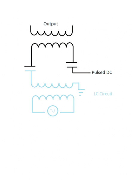

What about in this circuit? If the pulsed dc doesn't charge the capacitor completely, would this allow for amplitute modulation at the frequency of the lc circuit?

mfb said:
If your frequency matches and you can vary the DC pulse length or height, maybe.

What about that circuit in post 3. Can that possibly produce an amplitude modulated signal?
Samson4 said:
Understood, thank you for clearing that up.
Possibly

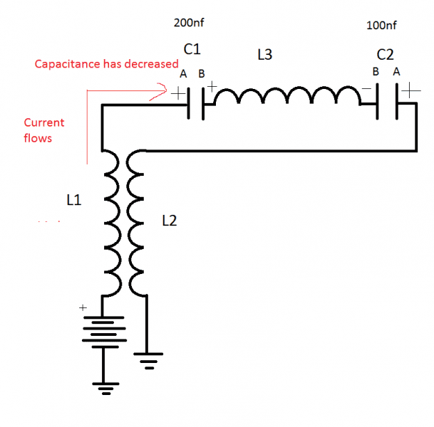

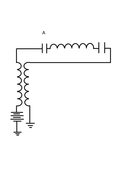

Capacitor A is asymmetric, with the electrode on the left having twice the capacitance as the electrode on the right. Using the change of capacitance when the system oscillates, wouldn't the oscillations sustain themselves?
  • Circuit schematic of an LC tank with a series-connected capacitor labeled A and an inductor, linked to a second coil, battery and two ground symbols.
There is no such thing as an asymmetric capacitance. Capacitance is a property of the capacitor, not of its electrodes.
You can put some active, amplifying element there, but then the drive source is obvious.
But what if we are talking about two separate plates? Can we have two separate plates that we are treating as two separate capacitors?
Two plates far away from each other without anything else nearby? They will act like two independent, tiny capacitors against ground. No coupling in between...

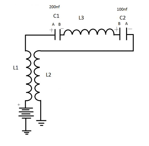

Circuit schematic with battery and coils L1 and L2 on the left, capacitors C1 (200nf) and C2 (100nf) connected by inductor L3 across the top, terminals labelled A, B and polarity signs.

Ok, I've been thinking on this for a couple days now. I still don't see the solution in this circuit.
L1 initially is a changing magnetic field, inducing a field into L2. L2 is wired so that the induced current charges C2a negative.
The battery charges C1a positive.
Now this is where I am lost.
The magnetic field at L2 will now collapse, and charge C2a positive.
L3 will also collapse and charge C1b positive and C2b negative.
But; the battery supply is still charging C1a positive, while L1 will be sustained.
Does C1a react like a change in capacitance and discharge? If it does, will it change the polarity of the magnetic field at L1?
or
Does the electric field between C1a and C1b forbid current from being induced by the collapsing magnetic fields at L3 and L2?
You can combine the two capacitors to one, it will not change the setup.
For a realistic circuit you'll need a resistor in it, otherwise it will probably oscillate forever.
It is probably easier to analyze the setup with calculations instead of qualitative descriptions.

So this would work and oscillate until the battery lost it's charge? Is there a circuit like this I can read on. That's the main problem, I don't have a resource for this type of setup.
That circuit is a linear one so there is no possibility of modulation unless you want to include some strange behaviour inside the battery (not altogether possible but . . . ). As you haven't included any switches then I am not sure how you want this circuit to do AM.
If the battery is a true voltage source then it has no internal resistance and it can dissipate no energy and the solution is indeterminate. If, as you should do, you introduce some resistance in the circuit you can combine the battery resistance, wire resistance etc. as a small series resistance on the output connection of the battery and you can consider it as a normal RLC circuit. (It is always best to reduce complicated networks as much as possible before analysis)
No net charge can leave the battery after the first cycle of the resonance because the Capacitors are open circuits. It will not 'go flat'. There will be an oscillation with a natural frequency of 1/2π√(LC) where C is the equivalent Capacitance to the two Capacitances in series and the L is the equivalent to the network of self and mutual inductances (I assume that L1 and L2 are coupled in some way?). The oscillations will die down exponentially and the final voltage across the Series LC part of the circuit will be equal to the battery voltage. The only energy lost will be the initial energy that flowed into the circuit at switch on (CV2/2) and the number of cycles to drop the energy to 1/e will be the Q of the circuit..

This circuit isn't for Am it's for producing the frequency that will be AM. With this in mind, how would you keep the circuit oscillating?
L1 and L2 are coupled. Adding an induced load and resistor at L1, would that keep it oscillating?
No, as there are no ideal electronic components. Even with superconductors you would still get some damping from the emission of electromagnetic waves, and the system would reach an equilibrium after a while.

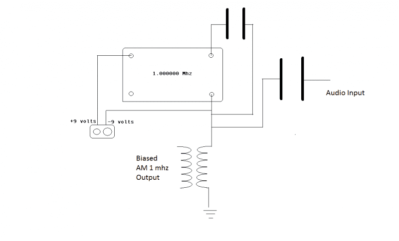

I altered a simple Crystal AM transmitter circuit to meet my needs. I am basically trying to get am modulation without the use of a diode. Does this meet the criteria? Also, the output from audio sources such as iPods are dc biased correct? If I am wrong in thinking this then this whole circuit is doomed from the get go.
Schematic of a 1.000000 MHz oscillator module with +9 volts and -9 volts supply pins, its output feeding a coupling capacitor, an audio input capacitor, and an inductor labelled Biased AM 1 mhz Output to ground.
