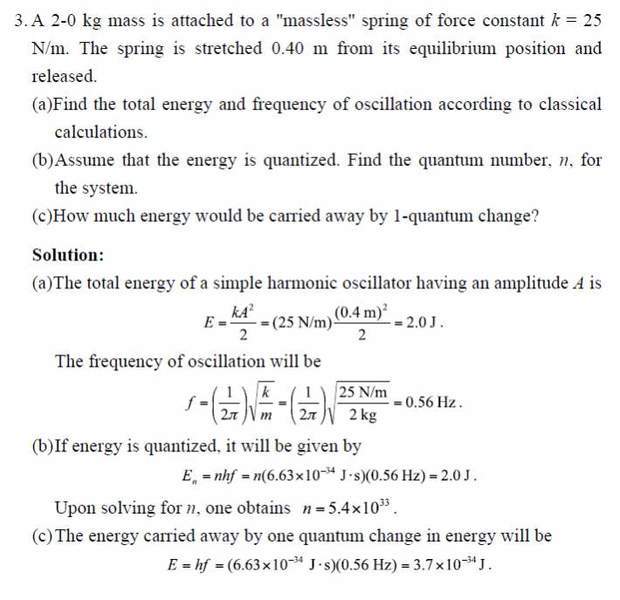

I have an example class yesterday, but one question troubled me.
In part (b), why does E=nhf?
For me, it seems E=nh is enough, why does the equation involve frequency f after quantization?
  • Worked solution to a textbook problem on a 2.0 kg mass on a spring with k = 25 N/m stretched 0.40 m: energy E = 2.0 J, frequency f = 0.56 Hz, n = 5.4×10^33, and energy per quantum change E = hf = 3.7×10^-34 J.
One answer might be: The unit of E (energy) is a Joule, the unit of h (Plank's constant) is Joule time a second. If you want the equation to be correct you need to multiply h with something that has units of 1 over a second.Roman.
What do you mean "E = nh is enough"? That equation is not correct, because as pointed out above, the units are not correct.
h = energy per cycle.
f = number of cycles per unit of time.
your quantization must include a quantization of time.
Energy within a single system is quantized, but there are different energies that result from following the E=nh model in different systems, so if you consider every possible system energy is continuous, just like the light spectrum.
