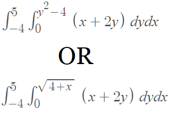

Hello. I have this double integral I have to calculate.
Shown below
242015

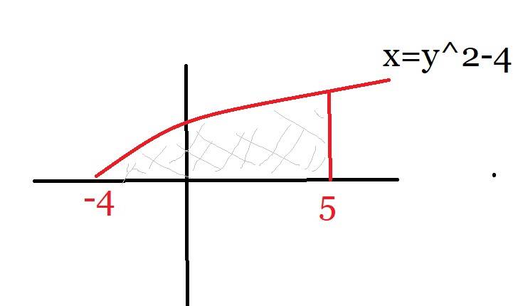

So i drew sketch.
242016
And I do not understand, how to write integral for calculation, which I should use, X or Y on limit?
242017
Is one of them right?
First answer gives me 65,7
Second 383,4

I wrote that integral for area I need to calculate.. the are between functions x=y^2-4; y = 0 and x=5

X limits are from -4 to 5 and Y limits are from 0 to sqrt(4+x)?
Yes. To answer your original question: the second is correct. For an integration over y you need a limit that is a function of x
and 65,7 is not the right answer :D
The result of integrating over y is a function of x only. Then you integrate that over x
I do not get it, why is 65,7 wrong?
I got the same result as calculator and it says it is wrong (online test)
Beats me. I find ##\ (xy+y^2) \Big |_0^\sqrt{x+4} = x\sqrt{x+4}+x+4 \ ## Integrate that from -4 to 5 (I use a calculator too) gets same answer as you.
Now the hammer: If we do the integration over x first, the limits are ##y^2-4## and 5
I find ##\ ({1\over 2}x^2+2xy) \Big |_{y^2-4}^5 = 12.5 + 10 y - {1\over 2} (y^2-4)^2 - 2y (y^2-4) \ ##
Integrate that from 0 to 3 using the tool again gets me the same answer again.

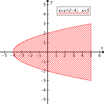

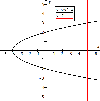

There is no indication in post #1 that ##y \ge 0##. Based on that post, the region you are integrating over should extend down below the x-axis.
Likes BvU
o:)o:)o:)
Like this.
242024
242025
Yes, so it looks like it was just all times 2 :)
Be Careful about such a leap.
Added in Edit:
I should have said:
No. It's definitely not as simple as multiplying by 2.
