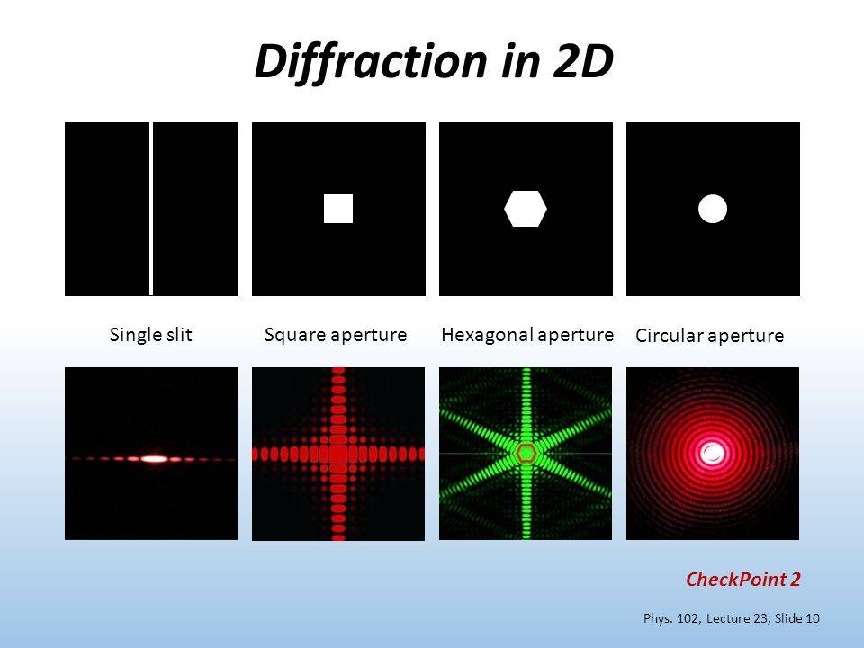

Yet, it looks to me like the patterns are creating by randomizing the paths at origin, and then interfering with the paths of the particles, where upon they paint that particular randomization pattern. What if the slits were instead round holes, or hexagonal shaped holes. Wouldn't they draw different interference patterns as a result of the differing shapes? If each particle were shot straight through one of two slits I doubt if there would be any pattern at all.
Yes. Here are some examples of diffraction patterns from single slit/single apertures:
(source: Phys 102 – Lecture 23 Diffraction. http://slideplayer.com/slide/3866721/)
