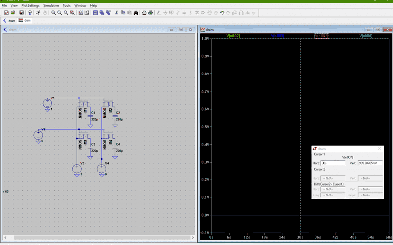

Allo,
There appears to be a problem when I was observing simulations of a DRAM cell in LTSpice IV.
The figure attached shows the circuit.
The circuit is an array of four DRAM cells in a two by two array. Each cell is a composition of a capacitor at 220μF and a N channel MOSFET.
Node 002 is at the positive end of C1, node 003 is the positive of C2, node 007 is the positive of C3 and node 008 is the positive of C4.
When the first wordline, V1, is high, 1 bit, at +1V, and the first bitline, V3, is high too, 1 bit, at +1V, the others low, C1 should be charged and the rest discharged. However, when the model is ran C1 and C3 are both charged. In the figure, both node 002 and 007 are at +1V. Before the test, all capacitors were discharged when both wordlines and bitlines low at 0V. May it be something wrong with the transistors? I suspect they are the wrong type of transistor, because a DRAM cell requires a standard FET?
If I am doing something incorrect or invalid please point out and explain.
Thanks in advance,

firstly, capacitors in DRAM cell not only leak, sometimes they also Charge by a mistake. so refresh means that some Caps need to be zeroed down to 0v , some maxed up +3.3v. you must have a voltage level detector in there. if after 70 or so microseconds a Cap voltage is below central threshold (1.65V) it means it was holding 0v and charged up errorously,so you must discharge it back to 0v during the refresh process. if Cap voltage level is beyond central threshold it means it was originally holding 3.3v but got discharged so you must recharge it up to 3.3v . main goal is to guarantee that Caps will hold their voltage levels below, or above central threshold for 70 or more microseconds. if that rule is violated threshold voltage level detector will make a mistake and legal voltage level never be recovered. will be lost, (overwritten by the second voltage level).
