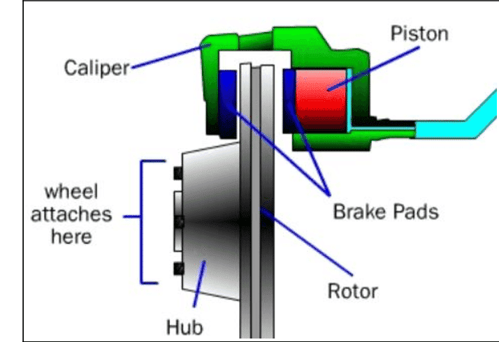

I have a hollow-cylinder wheel model, braked with brake pads located at a distance d of the wheel's center axis. The brake pads have a contact area S. They are also forced towards the wheel with a pressure p. The contact between the brake pads and the wheel is done with a friction coefficient μ.
I call F the force of the brake pads onto the wheel.
Those brake pads create momentum M on the wheel so that it has less angular speed.
I want an expression of this momentum within the boundaries of the model.
For now, I assume
F = μpS
M = Fd
If anyone can help me with this...
If you do, the force is zero (assuming that the brakes act symmetrically around the wheel) since force is a vector quantity. However, you can consider each small surface element and the forces acting on that (including frictional) and you should find that, although zero overall force, their torques do add up.
How would they act symetrically around the wheel? What kind of brakes are these?
Actually the problem gives the pressure and the surface area of the brake pad(s) so this is not big stretch.
You’re right, I was a bit fast there. I was thinking of a brake drum. The point that they may not add up purely constructively depending on size still stands.
Anyway, it is not the pressing force that creates the torque. The force of one pad is offset by that of the one on the opposite side of the wheel and either would not give a torque in the appropriate direction to slow down the wheel. The question becomes: What force does slow down the wheel and what is the corresponding torque?

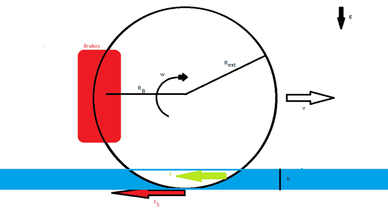

Yeah, I'm getting myself a bit confused:
Imagine we have a 4 wheeled vehicle of mass ## M ## moving with velocity ##v##. Then apply the brakes.
The maximum braking force ## F_b## we can apply so that the wheel doesn't "slip" (assuming equal weight distribution of ##M## )
$$ F_b = \mu_s \frac{M}{4} \frac{r_w}{r_b} g $$
Now I would go to Energy considerations:
$$ \frac{1}{2}M v_o^2 + 4 \frac{1}{2}I \omega_o^2 = \frac{1}{2}M v^2 + 4 \frac{1}{2}I \omega^2 - \int F_{net} \cdot dx $$
##F_{net}## is effectively what is acting to stop the vehicle, but the only force I can find that could do the work is the static friction? From what I recall "that is a is a no-no"?
Surely the force is coming from the brakes, but its isn't obvious (to me) how it must be acting. For instance ## F_b## could be acting in any direction, purely vertical perhaps, in which case it can do no work to stop the vehicle??
So I'm kind of stuck thinking ## F_{net} = F_s ##...

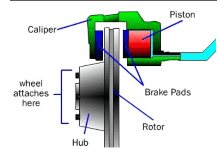

I have a disc of radius R spinning around its center axis
I now press an undeformable brake pad onto the disc
Thus, the pad is fixed while the disc keeps rotating, but there is friction between the disc and the pad
This friction obviously acts against the rotation of the disc
This is what torque I want to figure out.
An image may be more valuable :

@hutchphd gave you that result above ( well,the force anyhow...) Finding the torque is just a matter of multiplying that expression by ##r##.
My concern is there will be a force that can be applied by the brake that can exceed the "no slip" condition if you aren't careful with selecting ## \mu ##. This may be perfectly fine. I was toying around with what I believe to be your next step " how quickly will the vehicle stop or in what distance if we don't allow skidding".
https://www.physicsforums.com/threads/car-brake-locking-stopping-distance.920358/
I glanced over this thread and it appears that it is "static friction" ## F_s## that is stopping the vehicle, I'm not sure where I got the idea that static friction can do no work.

Using the diagram, I made above:
The ## F_{net} ## using energy considerations is not the static friction force ## F_s##, its ##F_b## on the rotor. The ##dx## is actually ## r_b d\theta ##
Invoking the "no slip" condition between the tire and the road ties ## \theta ## to stopping distance ##x##.
I hope I've got a better understanding now.
