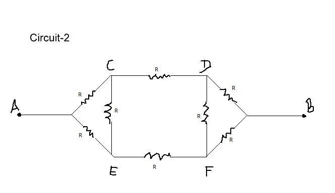

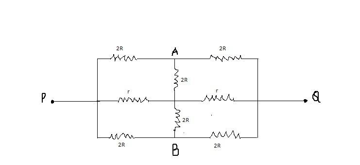

Calculate the effective resistances between P and Q in circuit-1 and A and B in circuits 2 and 3 in each of the following circuit diagrams.
In circuits 2 and 3 the resistance R has the value 1Ω.
2. The attempt at a solution
1. Why does the AB branch get removed in circuit-1 when we simplify the circuit further? Is it because A and B are points at equal potential (equipotential)? But then why are A and B equipotential points?
2. Why do the CE and DF branches get removed in circuit-2 when we simplify the circuit further? It s because points C,E and D,F are equipotential pair of points. But why are they equipotential points?

For the first circuit:
You are right. Points A and B are points of equal potential. The first circuit has three branches arranged in parallel. All the branches have two resistances of the same value. The potential drop across all braches is the same in a parallel circuit. Considering the potential difference between points P and Q is 'V', what do you think will be the potential drop from P to A or P to B?

If P and Q were equipotential, no current would flow through the circuit. P and Q aren't equipotential. A and B are.

Oh yes. I meant A and B. Sorry for the typo. So why is the potential difference from P to A and P to B the same? That is what the question essentially reduces down to.

Because :
1) The potential drop across all three branches is the same
2) All the branches have 2 resistances of the same value
So if the potential drop across two resistances is 'V', across one resistance it will be 'V/2'.
Read up on the basics of division of current and voltage.
The second circuit can be solved by Delta-Star conversion.

Suppose the potential at P is VP, potential at A is VA and potential at B is VB. So you are saying that VA - VP = VB - VP which means VA = VB. But what is the logical explanation behind VA - VP = VB - VP?

And the potential drop across all the 3 branches will be the same only if all the 3 branches are in parallel, but are they?
Two resistors are said to be in parallel if the ends of one resistor are connected across the ends of the other. So each of the two resistors can be a summation of a large number of resistors in parallel too, in this case two.
But the two resistors are not in series because for two resistors to be in series they need to be connected end-to-end and the same current should flow through each of them. How can we be sure that the same current is flowing through each of the two resistors in each branch?
Would it be easier to understand if you imagine taking away the two 2R resistors drawn vertically between A and B ? Then you conditions are fulfilled and all three intermediate points are at V/2, so re-inserting the two 2R resistors has no effect.

Why ? No potential difference ##\Rightarrow## no current, so no influence at all. You could even short-circuit between A and B in this symmetric case.

Don't know what to say. You could look at the Wheatstone bridge : the top half and the bottom half of circuit 1 are similar to that; you know the various R so you can determine ##I_G## in the derivation there is zero.
Or you could do a lot of work and use Kirchoff's law for the whole thing to come to the same conclusion.
Using symmetry really is the easiest: assume these 2R in the middle carry a current. Flipping upside down would flip the current sign, right ?
But the flipped picture is identical ##\rightarrow## same current. So current = - current ##\rightarrow## 2 current = 0 ##\rightarrow## current = 0.

Wheatstone bridge is a good explanation. Thanks for that. So circuit-1 is done now. What about circuit-2 and circuit-3?

In 2 you can re-use the flipping trick.
