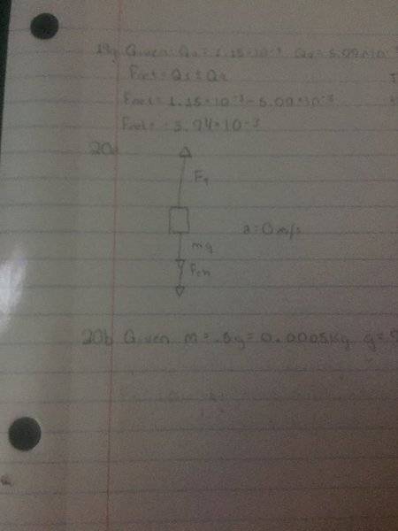

Okay so i thought the regular force tension equation would work but it didnt. I used Ft=w+ma. Using the variables I put the variables in each one. I did Ft=0.0005kg*9.81m/s^2+0.0005kg*0m/s^2 and got 0.004905, but turns out that is not the correct answer. The answer I'm supposed to get is 0.00546 N and I don't know what to do. Also I'm not sure what would work.
My free body diagram, the first one is for Part A and the second one is for Part C.

Can you draw the free-body diagram?
Yes I already drew it.
We can't see it .
SammyS said:
We can't see it .
Don't mind the things above my drawing

@berkeman has already told you that it's nearly impossible to see content of your posted images. This one is no better.
Also, it's quite confusing when you use the same title on more than one thread.

You may find it easier if the free-body diagram shows both balls (ball B and ball C). Each ball will have three forces acting on it. Also, be sure to label and dimension the strings.
Note that this is a static analysis -- nothing is moving.
The problem is the fbd doesn't appear to show all the forces acting on the balls. One force has been missed despite the title of this thread.
