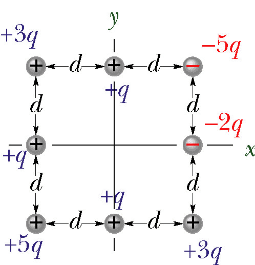

In the figure, four charges, given in multiples of 5.00×10-6 C form the corners of a square and four more charges lie at the midpoints of the sides of the square. The distance between adjacent charges on the perimeter of the square is d = 1.30×10-2 m. What are the magnitude and direction of the electric field at the center of the square?
The magnitude of E?
Ex?
Ey?

It's been a long time since I did this but my reading of the problem is that q=5.00×10-6 C, in other words the charges are specified in multiples of 5.00×10-6C. Best work out the problem in terms of q and substitute the value at the very end.
I think the equation you have is correct. Replace Q with -5q, -2q, q, +3q etc
Remember that the electric field is a vector that points away from +ve charge, towards -ve. So I would guess it's a matter of adding together 8 vectors.
Take advantage of symmetry to simplify things. For example, the fields from the two +3q charges on the diagonal will cancel each other out at the center of the square. Several such "tricks" are available here.
Ah, I didn't know that. So you can cancel out the +3q and the +5q.

? How would that work? They're not across from each other with the center of the square between them. And the two +3q charges are already "gone" from the picture, having canceled each other out across the diagonal. Further, +3 does not equal +5, so they don't cancel numerically.
For the fields from charges to cancel at a given location they must:
1. Be the same distance away from the location
2. Be the same sign
3. Be the same magnitude
4. Be located in opposite directions from the location (the two charges and the given location must be collinear).
Sorry, I wrote what I meant wrong. The 2 +3q's cancel out, then I erroneously said that the 2 +5q's cancel out, but now I see that one is -5q, so I need to fix my math.
So with those rules, the 2 +q's on the y-axis can cancel out.

I'd advise against plugging in any numbers yet, it just confuses things. There's more that can be done dealing with the q's.
Here's another hint: The field produced by some charge Q at a given location is the same as that of a charge -Q located at the same distance in the other direction (again, collinear items). So this will allow you to sneakily move charges across the square (through the center!) and diagonally by changing their signs and adding them to the charges already there. You should be able to drastically reduce the number of actual charges that you have to deal with for the final field calculation.
Are you referring to the +5q and the -5q?
Sure. And any other charges that are symmetrically located across the center of the square. You should be able to reduce the original 8 charges down to just 2. Much fewer numbers to deal with! Saves the fingers and calculator buttons :)
Stop me if I'm wrong, but would you add them?
Move the -5q diagonally, and add it to +5q, making...+10q?
Move the +q across the square to the -2q, making -3q?

No, not right. You've paired away the charges down to two remaining. Now you need to find and add their actual electric fields at the location in question (the center of the square).
Fields are vector quantities, with both magnitude and direction. So you'll be finding the magnitudes using the kQ/r2 equation, and the directions are given by the location (and sign) of the charges with respect to the location in question (the center of the square in this case). Look up a picture of the field surrounding a charge to see the direction that the field points for a given charge sign.
Add the vectors to find the net resultant of the field at that location.
A positive charge's field lines radiate outward while a negative charge's field lines radiate inward.
kQ/r2 ---replace Q with 10(5.0E-6)=5E-5 and -3(5.0E-6)=-1.5E-5 ?

Although, come to think of it, I might've chosen to move the +5q from the lower left to the upper right to make -10q as the total there. Then both of the charges remaining would be in the first quadrant and have the same sign. Keeps all the trigonometry in the first quadrant where it's most familiar :)
-10(5.0E-6)=-5E-5
(9E9)(-5E-5)/(1.30E-2m)^2=-2662721893
-3(5.0E-6)=-1.5E-5
(9E9)(-1.5E-5)/(1.30E-2m)^2=-798816568
Is this the right direction? Would I add them together now? (I changed the 10q into -10q like you suggested)
Look at the diagram. Do the distances from the charges to the center look the same? What are the actual distances from the charges to the center of the square? You need to use the right distances in the field formula.
Remember: you are adding vectors here. You need to separate the vectors into their components and add the like components to find the components of the resultant vector.

the one with the -3 charge will stay the same, but the -10 charge is 1.84E-2 m away at that diagonal (pythagorean)
-10(5.0E-6)=-5E-5
-3(5.0E-6)=-1.5E-5
(9E9)(-1.5E-5)/(1.838E-2m)^2=-7343031.963
Right?
Sure. I think you can drop the signs on the charges at this point for the math operations to follow. You know the directions of the field vectors based upon the signs and the placement of the charges with respect to the center of the square, so you really only need to deal with the magnitudes of the vectors. Sketch the vectors and assign their calculated magnitudes.
Now you need to add the vectors find their resultant.
You need to check your calculations of the field magnitudes: I think you've swapped the distances for the two charge values. Also, you should use scientific notation for the results and with appropriate number of significant figures and the requisite units.
You're right, I mixed up the distances:
-10(5.0E-6)=-5E-5
(9E9)(-5E-5)/(1.838E-2m)^2=-24483133.84= -2.45E7 N/C
-3(5.0E-6)=-1.5E-5
(9E9)(-1.5E-5)/(1.30E-2m)^2=-10384615.38= -1.04E7 N/C

You'll want to redo the math, neither of your results are correct given the values in the expressions.
As for the next step, make a sketch of the setup. Assume that the center of the square is the origin of an x-y coordinate system and locate the two remaining charges accordingly. Sketch in the vectors representing the fields from the two charges. Use vector addition methods to find your resultant.
The numbers in the expression and the formula is correct. The result that you obtained is not correct.
  1. A classmate posted these equations. They got me to the correct answers.
    Do they look like known equations to solve problems like this one in particular, or was our work headed to this kind of thing? (also, I checked my math, and wow I messed that up...)
    Ex=(5kQ/(d^2))cos45+(3kQ/(d^2))
    Ey=(5kQ/(d^2))sin45
    E(magnitude)=SQRT(Ex^2+Ey^2)
    Ey=(5kQ/(d^2))sin45
They are exactly where you were headed. Do you understand what they represent?
Where did the 5 and the 3 come from?
They represent the charges that remain: 10Q and 3Q. But your classmate did something clever with the distance for the charge on the diagonal, since it's √2 d. When squared that makes 2 d2, and he divided the 10 by the 2 leaving 5. That's why the terms for each charge use d2 in their denominators, despite the fact that the distances are actually different.
