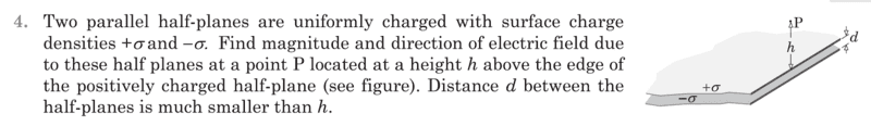

Two parallel half planes are uniformly charged with surface charge densities ##+\sigma## and ##-\sigma## . Find magnitude and direction of electric field due to point ##P## located at a height ##h## above the edge of the positively charged half-plane . Distance ##d## between the planes is much smaller than ##h## .
refer to the image
I assumed the plate areas to be ##S## , then electric field at ##P## should be $$E_P=E_{+\sigma}-E_{-\sigma}=\frac{k\sigma S}{h^2}-\frac{k\sigma S}{(h+d)^2}\approx \frac{2k\sigma S d}{h^3}$$ but i think it's wrong here as ##P## lies at the edge , so it won't receive electric fields in a way which would satisfy the aforesaid equations . Morever , the area is unknown and i doubt that it could be found .

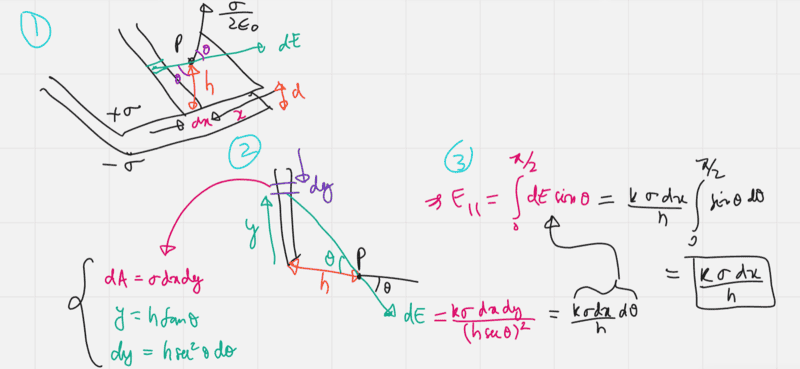

Actually i was kinda motivated by Krotov problem ##3.12## . And thought it would work here as well . In that problem , we were asked to find force of interaction but as i had suspected the issue is due to the location of the field that we needed to take into account . Here we need to find the field at the edge while for the Krotov one , we need it at the center .
Any elaborate ideas how to move forward? I tried to integrate strips , don't think that works either.

Also , i am getting the field due to the positive plate a converging integral , not sure how to take them together as you mention . I have provided my working as of now , sorry for it being messy . So , i marked them 1 ,2,3 in order . Btw there is a minor error in the work , it should be ##dq=\sigma dx dy## instead of ##dA## .
If you orient the strips as you have, the point P will not be vertically above the end of a typical strip. So, the geometry and trig that you used will not apply to the typical strip. I recommend that you orient the strips as shown:
The strip is an infinite, uniformly charged line. The field at P due to the strip is easy to find using Gauss' law, or you might already be familiar with the field of an infinite line.

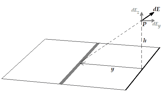

The strip has an infintesimal width ##dx## (assuming the ##x##-axis is oriented in the plane of the sheet and perpendicular to the edge of the semi-infinite sheet). Can you see how ##\sigma##, ##\lambda##, and ##dx## are related?

Ok. I was choosing the x-direction as perpendicular to the strip, while you are choosing the x-direction along the length of the strip. Let's go with your choice. Then, the y-axis will be perpendicular to the strip and the width of the strip will be ##dy##. Note that if we choose a small length ##dx## of the strip of width ##dy##, then ##dA = dx dy##. Substitute this expression for ##dA## into your equation ##\sigma dA = \lambda dx## and simplify.
Well , simplifying gives me ##\lambda=\sigma dy\implies E=\frac{\sigma dy}{2\pi\epsilon_{\circ}\sqrt{h^2+y^2}}## so this is the radial field due to the positive half plane plane . Similarly for the negative half plane , it is ##\frac{\sigma dy}{2\pi\epsilon_{\circ}\sqrt{y^2+(h+d)^2}}## . It seems a bit weird , not sure what to do next .

##\frac{\sigma dy}{2\pi\epsilon_{\circ}\sqrt{h^2+y^2}}## is the radial field ##dE## due to the strip of width ##dy## located at ##y## in the positive half plane.
Which component of ##dE## do you think you should be working with at this point?
How would you set up an integral to evaluate this component of the total field at P due to all of the strips making up the positive half-plane?

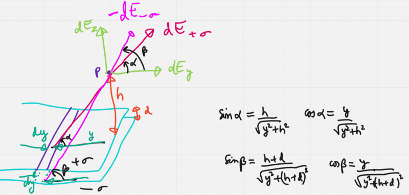

As evident from the attached figure , $$dE_y=dE_{+\sigma}\sin\alpha-dE_{-\sigma}\sin\beta$$ $$dE_z=dE_{+\sigma}\cos\alpha-dE_{-\sigma}\cos\beta$$On doing the integration we get : $$E_y = \frac{\sigma d}{2\pi\epsilon_{\circ} h}$$ $$E_z=0$$ Hence , $$\boxed{\vec{E}=\frac{\sigma d}{2\pi\epsilon_{\circ} h} \hat{j}}$$
Ok. I believe those answers are correct.
It's nice to see that the integration for ##E_z## gives zero in agreement with post #10 where you had ##E_z = \frac {\sigma}{4 \epsilon_0}## for one sheet. So, the two oppositely charged sheets together give ##E_z = 0##.
