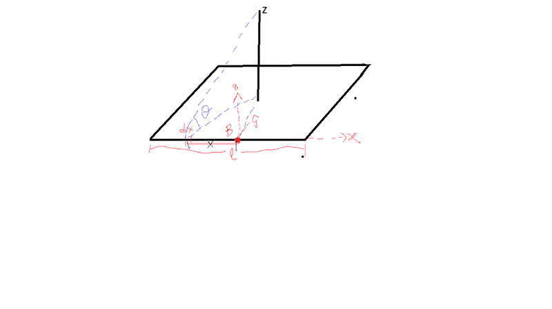

Find the electric field a distance ##z## above center of a square loop of wire,each of whose sides has length ##l## and uniform charge per length ##λ##
##dE=\frac {1} {4πε_0} dq \frac {1} {r^2}## (magnitude)
I have a pic.
So ##dq=λdx##
##r^2## is here
##x^2+(\frac {l^2} {4})+z^2##
##E_x=E_y=0##
so the equation becomes,
##dE=\frac {1} {4πε_0} dq \frac {1} {x^2+(\frac {l^2} {4})+z^2}sinθ## which its
##dE=\frac {1} {4πε_0} dq \frac {1} {x^2+(\frac {l^2} {4})+z^2}\frac {z} {\sqrt {(\frac {l^2} {4})+x^2}}##
From there I get
##E=\frac {zλ} {4πε_0}\int_{\frac {-l} {2}}^{\frac {l} {2}}\frac {8} {(4x^2+l^2+4z^2)(\sqrt {l^2+4z^2})} \, dx##
I stucked at the integral part.I tried calculator but it didnt work out.And before that, are my equations true ? Of course for result I have to mulitply this by ##4## so the answer is
##E_{total}=4E##
It will be in the vertical direction
See if you can find the mistake in setting ##\sin\theta = \frac {z} {\sqrt {(\frac {l^2} {4})+x^2}}##
Looks right for me ?
What is the length of the hypotenuse of the right triangle which has the angle θ indicated in your sketch?
I see yeah thanks
I found but I used calculator to find ##\int_\frac {1} {(4x^2+l^2+4z^2)^{\frac {3} {2}}} \ dx ## is it too bad ?
The denominator should be raised to some power other than 1.
I fixed sorry my typo
Its hard to write such things in here
I'm not sure what you are asking here. If you get a final answer, I can check to see if I get the same answer.
No I found the answer,Just For solving the integral.I used calculator.Then I put the numbers and I found the answer.
Just I couldn't see the Solution of integral.And asked you Is is bad to not solve such integral.Its stupid question I know :/
I think it's OK to use a calculator to do the integral.
To do the integration without a calculator, note that $$\int \frac{dx}{\left(4x^2 + l^2+4z^2 \right)^{3/2}} = \frac{1}{8} \int \frac{dx}{\left(x^2 + a^2 \right)^{3/2}}$$ where ##a^2 = \frac{l^2}{4}+z^2##. Let ##u = \frac{x}{a}## to put the integral into the form $$\frac{1}{8a^2} \int \frac{du}{\left(u^2 + 1\right)^{3/2}}$$ Then try an appropriate trigonometric substitution.
