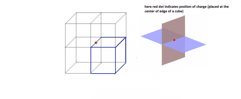

I know in such type of questions we should try to enclose the charge completely and symmetrically by as many bodies requires as that of the given body.
Let's say if Charge Q is kept at the mouth centre of a hemisphere .Here a hemisphere is given so we know if another hemisphere is placed below it will enclose the charge completely by a sphere.So,the flux through one hemisphere is Q/2ε0
But This was a simple case but when there is a cube I have difficult time in covering the charge completely for example when charge Q is placed at the centre of the edge of a cube.Please guide me.

Well ,
In this case I am required total four cubes to cover Q completely,I don't understand ,how?
gracy said:
Well ,

I think you are trying to describe how to visualize the intersection of two planes
https://www.physicsforums.com/attachments/fourcubes-jpg.88863/
Yea, so clearly it took four cubes.
Now could you please explain your orange example
No. If I knew an easy way to explain it I would have done so rather than suggest you try a physical example. Besides, you understand the geometry now, so what would be the point?
OK.This time I took help of intersection of two planes but what if asks charge Q is placed at the corner of a cube?How would I decide how many cubes it would take to cover the charge completely?
Come on gracy. What do you think? You have already figured this out for two cases, use the same reasoning approach that you used for those, and apply it here.
I think what Dale is suggesting is you imagine the fraction of the volume enclosed by one of the cubes. If the charge is located at the corner of a cube the fraction of the volume enclosed by the cube is 1/8. The reciprocal of that is the number of cubes needed to completely enclose the charge.
