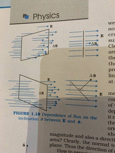

@PeroK sorry but your link doesn’t explain it why it’s product of E and A called flux. I was reading my NCERT Book and Maybe I got it. If you see the picture you can well see that at points R and S field is stronger at R because there are more number of field of lines crossing the surface. And The number of field of lines crossing a surface is directly proportional to the magnitude of field at that point. So if we place a surface delta S in a field E perpendicular to it then the number of field lines crossing it is proportional to EdeltaS and that is where E comes in the equation of flux.
It's really about the cross-sectional area of a surface in a given direction. You can see in the second diagram that a surface that is titled at an angle to a field presents less surface area in the direction of the field.
Again, if you think about the field as a stream of particles, then a titled surface of a fixed size intersects less of the stream. A bit of geometry shows you that it depends on the cosine of the angle between the stream and the normal to the surface - and that's the dot product.

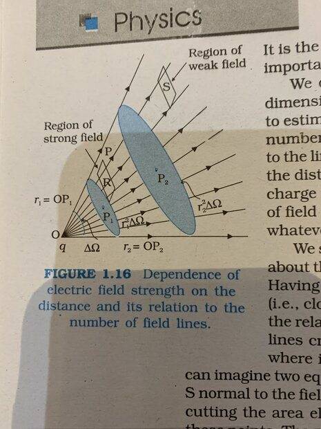

rudransh verma said:
Sorry but I don’t agree with you , flux or amount of field lines also depends upon electric field magnitude E and not just on area or angle between them.
Don't mix up flux with flux density.
For a magnetic field, the flux is the Weber, and the flux density is the Tesla.
For your picture is post 12 , P1 and P2 have the same flux, but P1 has a greater flux density.

@rudransh verma
Because the electric field can be understood as the density of field lines passing through space, the ##\int \vec E \cdot d \vec A~## is obviously used to calculate the number of field lines passing through an area, and the number of field lines passing through an area is equal to the electric flux passing through this area.
