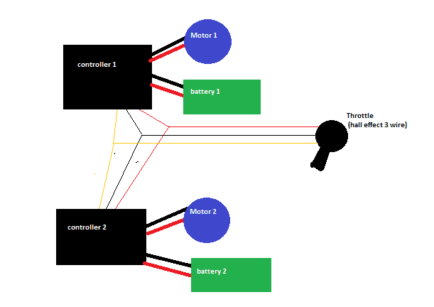

Hey everyone, I am building an electric bike and I was wondering if you can take a typical hall effect hand throttle and connect it to two controllers, so it can control 2 identical motors with separate power supplies giving each motor = amounts of voltage to run the motors at around the same rate. Attached is a simple wiring guide for how I am setting it up.

This might sound incredibly ignorant on my part, but why would you even bother? Just run the motors in series/parallel through a rheostatic throttle. Why would you drag Mr. Hall out of his grave for something so simple?
Incidentally, why would you need 2 motors for a bike? One larger one would be a lot more practical.
I'm trying to do this at low cost with high power and controllers that can handle more that 2000 watts and more than 50 amps are expensive so I'm trying this idea

That depends what you mean by "at around the same rate". It is possible to have your one throttle control both controllers with (at most) some glue circuitry, but unless both the controllers are capable of being synchronized somehow the motors (DC?) will likely run at significantly different RPM and torque which I doubt you can tolerate.

The original question is can you use a single throttle control with two different controllers to control the speed of 2 identical motors.
The answer to that is:
1) If the two motors are locked together (that is, their speeds are a function of each other, either by being on the same shaft or both in contact with the road by fixed gears) then;
a) you can only run them from one control if the motors are torque controlled. That way, you simply get the sum total of the torque and small differences are unnoticed, and when you back off the throttle, or set it higher, you would do so until you sense the sum torque (viz. acceleration) is as you want it.
b) you cannot run them as speed control because it is unlikely to be exactly the same speed, so they can fight each other with one trying to slow the other down (one applies a -ve torque while the other a +ve torque as they both fight to get to their 'set speed').
2) If the two motors are summed on to a final output (that is, their outputs are put through some differential device that adds their respective speeds and torques) then they should be controlled for speed, because if controlled for torque then one can slow down to nothing whilst the other is running fast, yet both can put out the same torque and achieve whatever is the speed required.
Are your motors torque or speed controlled, and how are they connected?
I suspect the "control" is just some type of PWM that responds to the throttle with no motor feedback, so combining two controllers and two motors likely has no issue. Using a single throttle with two controllers, likewise no big deal, it will either work splitting the wires or with a simple buffer circuit.
That would be a function of the details of the system and the motor type, to determine that. If they were permanent magnet AC ('DC pulsed') synchronous motors (as they would surely be, for weight efficiency) and were locked together and one PWM controller ran slightly faster than the other, then one would open its gates up and sink torque reaction back to the bus. Or are we talking about a motor/controller that has no regenerative braking - missing one of the benefits of having a motor/battery!?
Whilst the other motor's PWM circuits are desparately trying to dump current from the bus into the motor to accelerate the shaft to its PWM speed, the slower one is sinking current back again as if it were 'regenerating' because it is running faster than its set speed.
If the motors are locked on the same shaft, what you need to be 'simple' is one controller to operate two sets of drive bridges. Then you have to make sure the phases of the motor are mechanically set the same, too.
Multiple traction motor control is not as trivial as you might first imagine.
Devil is always in the details, for all we know the motors are not on the same wheel or perhaps one is a hub motor and the other driving via chain or belt.
Where I have confidence is that use of a single control voltage won't be a big issue.
Well, your confidence in the absence of all the information is remarkable!
It'll be a lot of fun to hear back from the OP what sort of ride he gets on the bike if he locks together two speed-controlled motors, on that advise. Please take a video if you end up doing that!
I'm confident there WILL be issues, just that using a single hand control won't be at the heart of them.
