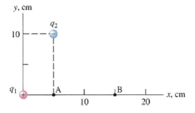

The figure below shows two point charges q1 = +5.4 10-8 C and q2 = -5.5 10-8 C.
(a) Find the potential at A
(b) Find the potential at B.
Coulombs Law
I found the potential at A, however I tried doing it with B but it says I have the wrong answer.
