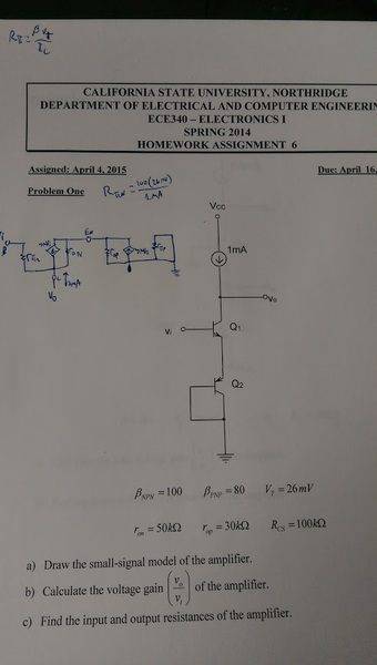

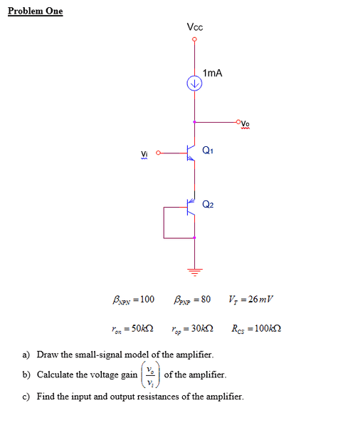

Hey guys, i can use some help with this problem:
Circuit schematic of a two-transistor amplifier: Vcc supplies a 1mA current source feeding Q1 (NPN) stacked over Q2 (PNP), with input Vi at Q1's base and output Vo at the collector node; labels beta_NPN = 100, beta_PNP = 80, V_T = 26 mV, r_o1 = 50 kOhm, r_o2 = 30 kOhm, Rcs = 100 kOhm.
I don't really have issues with part A, its more of part B and C that i can use some help with
Photo of a printed homework assignment sheet for ECE340 Electronics I, Problem One, showing a BJT amplifier schematic with an NPN transistor Q1 and PNP transistor Q2, a 1mA current source, and handwritten annotations; printed parameters include beta NPN = 100, beta PNP = 80, VT = 26mV, rπ = 50kΩ, re = 30kΩ, and RCS = 100kΩ.
You need to at least make an attempt.
once you have your small signal model try using nodal analysis, KVLs, KCLs, ohms law, etc to find an equation linking the parameters. Your goal is to find the transfer function.
As far as part C goes, can you explain to me what you think input and output resistance is, in words not equations
