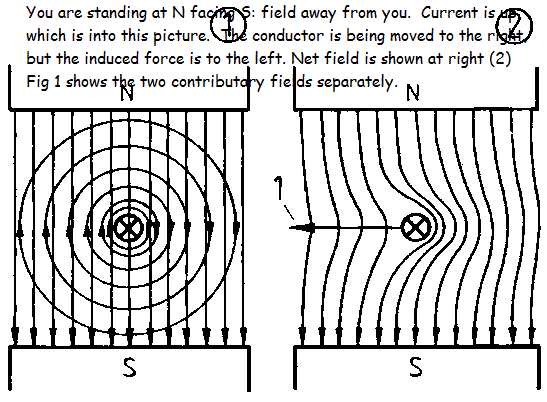

Say for you had a wire in a complete circuit inside a magnetic field (pointing inwards) perpendicular to the wire.
You move the wire across (to the right) , cutting lines of flux, this induces a current in the wire.
The induced current acts upwards using the dynamo rule (thumb is motion, middle finger is flow of electrons, first finger is field)
But since an induced current is created upwards in a magnetic field this means that a force is also created.
Using Fleming's left hand rule (thumb is motion, middle finger is conventional current and first finger is field), the motion of the wire is to the right.
More lines of flux are then cut, current increases, speed increases ect you get energy out of nothing?
How is this possible?
You are only considering one half of the picture. The magnetic field is also affected here too. If you point your left hand towards your right hand your fore-fingers point in opposite directions, can you guess what happens to the magnetic field?
It's not possible. The wire will experience a force that slows it down, not speeds it up. I believe you've mixed conventional and non-conventional current together, which will give you conflicting results.
Hold out your hands. Per the right hand rule the current (conventional current, not flow of electrons) is induced upwards. (Thumb to the right, middle finger upwards)
Per the left hand rule this upward current produces a force to the left. (When middle finger is upwards, thumb is to the left)

In the original case, you provided the force to the right, which moved the wire to the right through the magnetic field into the page. That created an emf upwards, which could cause a conventional current upwards.
Now that upward conventional current in the into-the-page magnetic field causes a force on the wire directed to the left.
Only one force is created by the current - to the left.
As to the magnitude of the force, that depends on the field and the motion, so is not obviously related to the original force you applied to the wire.
If you took a stationary wire and applied a constant force, the wire would accelerate, producing an increasing emf and (depending on the circuit the wire was in) an increasing current. So the force would be increasing in opposition to the motion, reducing the acceleration, until there was equilibrium with the wire moving at a constant speed with the electromagnetic force exactly balancing the constant applied force.

The current from my example also produces a magnetic field, how would I work out which way the field acts, and would this field cause motion in another direction?
See diagrams in http://hyperphysics.phy-astr.gsu.edu/hbase/magnetic/magcur.html
The general rule for the field caused by a current in a straight conductor is that, if the current (conventional + to -) is away from you, the field is clockwise around the conductor.
In your case; field into the paper, movement to the right, wire vertical, induced emf and resulting current (if any) upwards, then the magnetic field caused by the induced current is out of the paper at the left of the wire, into the paper at the right of the wire, left to right near the observer and right to left on the far side of the wire from the observer. So the overall field is strengthened to the right of the wire, weakened to the left of the wire and bent in front and behind the wire (from the observer's view.)
This diagram is from http://www.fastonline.org/CD3WD_40/CD3WD/ELECTRIC/GTZ021E/EN/B309_4.HTM and shows your situation viewed from below.
