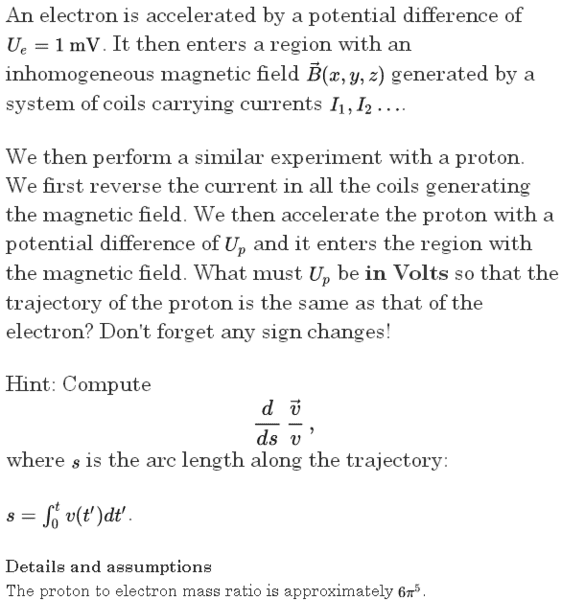

Electron in a magnetic field problem
The discussion revolves around solving a problem involving an electron moving in a magnetic field, where the participant struggles with understanding the relationship between acceleration and trajectory. The key point is that while the accelerations of an electron and a proton can be equal, their motions can differ significantly unless their initial velocities are identical. The conversation emphasizes the importance of converting time-dependent equations of motion into trajectory equations that are independent of time, utilizing natural parametrization. Hints are provided to guide the participant toward expressing the motion in terms of the trajectory parameter, leading to a differential equation that must be satisfied for both particles. Ultimately, the focus is on finding conditions for identical trajectories based on the derived equations.
Saitama
4,244
93
I was completely clueless about the hint so I tried the following:
The force acting on the electron is ##\vec{F}=e(\vec{v_e}\times \vec{B})##. The speed of electron in the magnetic always stays constant, only the direction changes.
Since ##\vec{F}=m_e\vec{\ddot{s_e}}=e(\vec{v_e}\times \vec{B})##. For proton ##m_p\vec{\ddot{s_p}}=e(\vec{v_p}\times \vec{B})##
As per the question, the proton follows the same trajectory, hence, ##\vec{\ddot{s_e}}=\vec{\ddot{s_p}}=\vec{\ddot{s}}##. This implies that ##v_e/m_e=v_p/m_p##. But this gives the wrong answer. Where is the mistake in this approach? :confused:
Okay, getting back to the hint, I see that it says to compute the derivative of unit vector along the velocity with respect to s but I am not sure how to use this.
Also, ##\vec{ds}=\vec{v_e(t)}dt=|\vec{v_e}|\hat{v_e(t)}dt## but still I do not see how to proceed.
Any help is appreciated. Thanks!

The equality of accelerations is not sufficient. For example, at the sea level, all free falling bodies experience equal accelerations. Yet you can have very different motions depending on the initial velocity. You get identical trajectories only when the initial velocities are identical. But if the velocities in your case are identical, then the proportion you got cannot hold. Contradiction.
But the thing is, accelerations do not have to be equal in identical trajectories. Trajectories are not motions, different motions can still have identical trajectories. For example, you can walk across your room slowly or swiftly: different motions, identical trajectories.

Hi voko! :)
Thanks for the explanation, I understand the mistake now but I am still clueless about approaching the problem. Can I please have a few hints?
The hint is that you should convert the equation of motion, which is time-dependent, into an equation of trajectory, which is time-independent. The problem already supplies a very strong hint, which is that you use natural parametrization of the curve. All I can add is "use the chain rule".

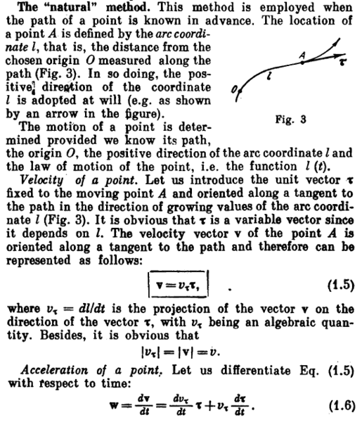

Since I am still clueless, I am referring a book. Here is the paragraph I am looking at:
Do I have to somehow make use of what is shown in the image? :confused:

##s ## here is a kind of ## l ##, except it has a special property. Here is another little hint for you: $$ \vec v = \frac {d\vec r} {dt} = \frac {d \vec r} {ds} \frac {ds} {dt} = ? $$

I still don't see what ##d\vec{r}/ds## represents, I have never seen anything like this. :cry: :confused:
## s ## is the parameter of the curve. The equation of the curve (trajectory) is given by $$ \vec r = \vec r(s) $$ The motion along the curve is specified by fixing ## s = s(t) ##. So $$ \vec r = \vec r(s(t)) $$ Then you just apply the chain rule.

We have
$$\vec{v}=\frac{d\vec{r}}{ds}v$$
The hint asks to compute ##d/ds(\vec{v}/v)##
$$\Rightarrow \frac{d}{ds}\frac{\vec{v}}{v}=\frac{d}{ds}\frac{d\vec{r}}{ds}=\frac{d^2\vec{r}}{ds^2}$$
I will leave for now and go to sleep. Thank you very much voko for the help you have provided so far. :)
You start with the equation of motion. Which is $$
m \frac {d\vec v} {dt} = \vec F
$$ Try to express as much as you can in terms of ##s## rather than ##t##.

$$\Rightarrow \frac{d^2\vec r}{ds^2}=\frac{e}{mv^2}(\vec{v}\times \vec{B})=\frac{e}{mv}(\hat{v}\times B)$$
So for the same trajectory, we need to have the above expression same for both the proton and electron, right?

So what do you get all in all?
  • #31
$$\frac{d^2\vec r}{ds^2}=\frac{e}{mv}\left(\frac{d\vec r}{ds}\times \vec B\right)$$
I don't see how to interpret the equation I have written above. :(
  • #32
The equation is correct. It is a differential equation of a naturally parametrized curve. You need to find out the condition that the curves corresponding to an electron and a proton are equal.
  • #33
Looking at the equation I have obtained, I would say the mv part should be same for both electron and proton, correct?
voko, sorry to ask foolish question but what does "naturally parametrized curve" mean? Can you please pass a link? Many thanks!
  • #34
Yes.
##s## is a parameter of the curve. If you take any function ##s' = f(s)##, ##s'## is also a parameter of the curve. But there is unique (up to an additive constant) way to parametrize the curve so that ##s## is equal to the length of the curve. This is natural parametrization. The condition on ##s## you have in #1 ensures that. Can you see why?
Also, do you see that ## \frac {d\vec r} {ds} ## is the unit velocity vector, a. k. a. the unit tangent vector?
Do you see that ## \frac {d^2\vec r} {ds^2} ## is the normal acceleration vector?
  • #35
voko said:
Yes.
So that gives ##U_p=-5.44 \times 10^{-7}##. Thanks voko! :)
