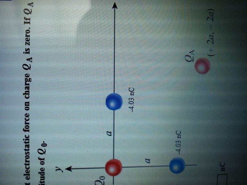

In the figure, the net electrostatic force on Q1 is zero. If Q1 = +4.99 nC, determine the magnitude of Qo.
Qo = (r0/r1)^2 * abs(q)*2cos theta
The figure is attached, please help, I'm so lost with physics II
hi loganblacke! :smile:
(have a theta: θ and try using the X2 icon just above the Reply box :wink:)
forces are vectors, so you have to add them as vectors
start by writing out the three forces as three vectors :smile:
How do i determine the direction of the vectors?
each vector will point along the line between the two charges :smile:
