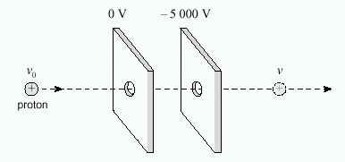

1. A moving proton has 6.4 x 10-16 J of kinetic energy. The proton is accelerated by a potential difference of 5 000 V between parallel plates. The proton emerges from the parallel plates with what speed?
a) 1.3 x 106 m/s
b) 8.8 x 105 m/s
c)1.8 x 106 m/s
d) 9.8 x 105 m/s
[itex]\Delta[/itex]Ek + [itex]\Delta[/itex]Ep = 0
Eki + Ekf = -Ep
6.4×10-16 + 1/2mv2 = -Q[itex]\Delta[/itex]v
v= √ [(-1.6x10-19×-5000)-6.4x10-16 ×2 / 1.67x10-27] = 437740.5241...
My answer doesn't match with any of the responses. What did I do wrong?
  • Diagram of a proton moving left to right through two parallel plates: the first plate is at 0 V and the second at -5 000 V, with initial velocity v0 and final velocity v labelled.
Looks like you have misplaced a minus sign or three.
I suspect you have applied the formula without understanding it.
Derive the relation you need using:
Gain in kinetic energy = loss in potential energy
Hint:
what is the initial speed of the proton?
should the final speed be greater than or less than this?
what does this say about the final kinetic energy vs the initial kinetic energy?
how does this relate to the change in potential energy (careful)?
Okay, I get it!
[itex]\Delta[/itex]Ek = Ekf - Eki
I just used that part of the formula wrong.
