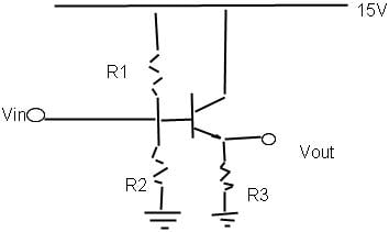

Use a follower with base driven from a voltage divider to provide a stiff source of +5 volts from an available regulated +15 volt supply. Load current (max) - 25mA. Choose your resistor values so that the output voltage doesn't drop below more than 5% under full load.
So I have to choose the base to be at 5 volts using R1 and R2. I'm fine with that. R2/(R1+R2) = 1/3.
Then the Emitter voltage will sit at about 4.4V. So I have to choose R3 to give 25mA when 4.4 volts are across it. That gives me 176 Ohms.
What I'm confused about is how to choose resistor values to get a less than 5% voltage swing. Someone mentioned to me that a rule of thumb is to make the current through the voltage divider 10 times the output current. But then I have R1 R2 and R3, and I don't know how to check if the voltage swing parameter is met.
Any help is greatly appreciated

There are two conditions to consider.
1) Minimum (zero) current draw by the load, R4
2) Maximum current draw by the load = 25 mA.
At these conditions the output voltage will be at the extreme points (above and below) the mean 5 volts.
Next you need to consider the beta or current gain of the transistor. Whatever value you choose, base current will be 1/(beta +1) of the emitter current and a change of that amount of current should not cause the base voltage to vary by more than 5%.
Hmm okay. Let me try and work this out. If I make R3 quite large, can I make the approximation that when Rload is connected that no current goes through R3?
So using what skeptic has said, I have IE * 1/(Beta +1) = IB
If there is no current being drawn by RL then IE=0 and then there is no change in base voltage? If there are 25mA being drawn, then IB roughly equals 0.25mA if my Beta is 100. So that base current across R1 can't be more than 5% of 5.6 Volts?
Here is a simple solution that can be refined by calculating the input resistance of the follower and using that to refine the base bias chain current.
Looking at this solution, I don't understand why you've chosen the currents that you have. Why is there 1 mA going through R3? Is it just arbitrary? Could you just have easily made half a mA and nothing significant changes?
The same question goes for the 2mA going through the base.
Are you saying that (R1 + R2) || (R3 + R4) would be the total input impedance? So I have to somehow use that to change R1 and R2 so that I still get 2mA?
And if everything I've said is right, I'm still not sure how to calculate the voltage swing.

Right, to go through the design.
You require 25 mA through R4 at 5 volts, nominal but no less than 4.75 volts.
This has to come from the emitter current.
The balance of the emitter current flows through R3 and in particular it all flows through R3 when there is no load connected (R4 = infinity).
There is no point making this larger than necessary for waste power reasons.
Since R3 and R4 are in parallel they experience the same voltage.
A 10:1 ratio is a good rule of thumb to avoid unwanted interaction so if we choose the current in R3 to be 1/10 (approx) the current in R4 this makes it 2 mA. In fact I have chosen 1 mA to be even better in these circumstances.
Given a transistor gain (beta) of 100 that gives a base current of .26 mA at max.
By the above reasoning if we set up a standing current of 10 times this in the bias chain of R1 & R2 this would be 2.6 mA. With such a standing current drawing up to 0.26 mA will disturb the chain voltages little. I have chosen 2 mA as close enough.
The larger you make the standing current in the chain the more stable the bias voltage will be (the less effect the base current draw will have) but the more current you will be wasting heating the resistors.
So we make R1 & R2 as large as possible, commensurate with the above reasoning.
Using the 10:1 rule allows us to use the simple voltage divider formula we discussed earlier.
[tex]{V_{R2}} = \frac{{R2}}{{\left( {R1 + R2} \right)}}{V_{total}}[/tex]
If we wished to reduce the bias chain current further and increase the values of R1 & R2 we would have to take into account the fact that it is not a simple voltage divider, but R2 is shunted (in parallel with) by the input impedance of the transistor. This impedance is beta times the emitter resistance (R3 in parallel with R4) and the divider formula becomes
[tex]{V_{R2}} = \frac{{RT}}{{\left( {R1 + RT} \right)}}{V_{total}}[/tex]
where
[tex]RT = \frac{{{R_3}{R_2}}}{{{R_3} + {R_2}}}[/tex]
and of course in this case
[tex]{V_{total}} = 15[/tex]
