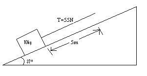

A string exerts a tension force of 55N on a 10kg block as it moves a distance of 5m up a frictionless incline. The string pulls parallel to the incline.
A) Find the total external work done on the block-earth system as the block moves 5m up the incline.
B)Find the change in gravitational potential energy for the block-earth system as the block moves 5m up the incline.
C)Find the change in kinetic energy for the block-earth system as the block moves 5m up the incline.

A)The external force should be the tension, so:
[tex](55N)(5m) = 275J[/tex]
B)I used trig (3-4-5 triangle) to find the height to go up 3m.
[tex]mgh_{f}-mgh_{i}=\Delta KE[/tex]
[tex](10)(10)(3)-(10)(10)(0)=300J[/tex]
C)[tex]KE_{f}-KE_{i}=\DeltaKE[/tex]
I am not sure what to do here because I don't know how to solve for velocity.
What does the work-energy theorem say about change in kinetic energy?

It asks what the change for the block-earth system is. On a free body diagram for the block, I have three forces:
I have the Normal force (80N) by the ramp on the block,
the tension force (55N) ,
and a weight force (80N in y-dir, 60N in x-dir). (no friction)
Is the other force doing work the Normal force?
If so, then I am not sure how to calculate the work because the distance is perpendicular.
Yes there are three forces. As you say, the normal force does zero work. So what is the net work, i.e. the total work done by all three forces?

This is where I am getting confused.
The problem is defining the system as block-earth, so if I am not mistaken, the weight force is the only force not doing work on the system.
That would leave Normal and Tension forces.
Normal is perpendicular, so equal to zero,
Tension is 275J,
so total work is [275+0] 275 Joules.

You said earlier I can't set the equations equal to 275J because there are other forces. What am I missing here?
Do I need to add in the weight force? I think it should be included in the block-earth system, not as external work.
The tension increases both the kinetic energy and the gravitational potential energy of the Earth-block system. If you ignore the potential energy change, it is as if the incline is not there and the block moves across a horizontal surface.
