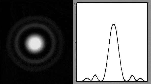

      An important topic in diffraction-limited optics is the Airy Disk, which is defined as "the best focused spot of light that a perfect lens with a circular aperture can make, limited by the diffraction of light." The diameter of the Airy disk's first rings drive requirements in many optical imaging systems like cameras, telescopes, infrared imagers, etc.
      Airy disk, intensity profile:
      A useful equation for use in optical and imaging system engineering is the "Airy Disc Diameter," also described as the diameter to the first "intensity zero," and is useful for estimating the smallest resolvable feature in an image.
      Airy Disc Diameter:
      [tex]D=2.44*λ*f_{number}[/tex]
      Where:
      D = Diameter to first intensity zero (microns)
      λ = Working wavelength (microns)
      f_number = Working f-number of the optical system
      This equation can be simplified further with some approximations for visual imaging systems. If we assume the image is primarily green (~546 nm, 0.546 microns), the equation simplifies to:
      [tex]D_{546nm}=1.33*f_{number}[/tex]
      Given this simplified version, we can see that imaging performance of a visible camera for example is driven by f/#, where a "faster" f/# (a.k.a. numerically lower) optical system (like a well-designed SLR camera lens) will give better diffraction-limited resolution. As a general rule, a digital camera's sensor will need pixels which are on the order of size of the airy disc diameter for the lens being used. Many modern cameras (especially cell phone cameras) are limited in resolving power due to the lens's f/#, rather than the pixel count on the image sensor.@Mech_Engineer I'm glad you liked the article. The Airy disc I believe is what you get for the shape and intensity of the focused diffraction spot if you assume a circular aperture. The result that I have in the article above results from assuming a square aperture. It is a somewhat specialized topic so that it hasn't received a tremendous number of views, but I'm so glad you found it interesting. :) :)
