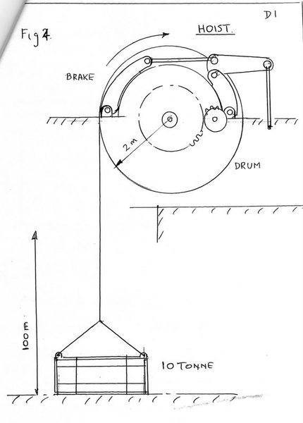

I am currently on an engineering apprenticeship and its mostly practical but i have been given a Newtons law question which i am finding very hard.
I have attempted it but still come up stuck.
I have attached the question with the drawing.
I have answered part a.
With S= (V.T)/2
S was 100 (area under the Velocity / time Graph)
T was 20 m/s
So that gave (S)100 = V(?) x (T)20 / 2
So V = 10 m/s
Now I'm really stumped on B and C.
Any help would be Great.
And now I've found this site i hope to give a lot of help back as i have nearly finished my partisanship.
Mike

I'm a bit confused by the work you've done so far. What is "T"? Is it a velocity, with units of m/s?
Thanks for moving it (sorry i put it in the wrong place), i had considered putting it in here but i thought engineering.
And T is time and i have put M/ in extra (dam) i would edit that but carnt (think cos its been moved).
As for doing it i think I've cracked it, so will post the answer tomorrow (if its wanted)

Yes, please post the answer when you get it. Glad that you're figuring it out.
