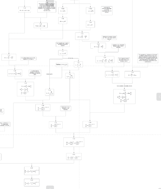

I have a degree in mathematical physics Birmingham UK 1967, and failed thermodynamics! I have re-connected with the topic over the past two years in an attempt, as a racing yachtsman, to understand the source of the aerodynamic force from a sail.
I have done a lot of reading, including Marchaj, Fossati, Gentry and I have studied Eiffel's research report in his book. I am now three weeks into reading Anderson to see if he can provide some answers and have come unstuck at Section 7.2 when for some unexplained reason, he introduces:

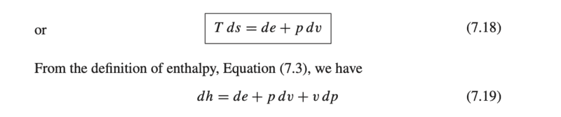

"A related quantity is the specific enthalpy, denoted by h and defined as h = e + pv (7.3)"
I have returned to my Physics text (Starling and Woodall) to find enthalpy introduced in Ch 13 "Equations of state" and read that it's involved in the work separating molecules (p284).
Now the aerodynamics of sails is not about state changes: Air is a simple and pretty ideal gas in all stages of sailing (as it also is in domestic flying). No state changes, no molecular attraction to overcome, so I'm confused.
Maybe you can help?
[EDIT] Why is it important? Because I'm trying to understand the "air can be considered incompressible below Mach 0.3" assumption which he "proves" in an incredibly long and complex argument which, inter alia, includes, and thus relies upon, the differentiation of the enthalpy equation at (7.19). [/EDIT]

But the temperature of the air will change due to compression - it doesn't matter if the change large or small, the process (air over a wing or sail) is not isothermal.
I don't want to use isothermal equations.
The aerodynamic process is not exothermic or endothermic and there is no change of state (or phase), between gas, liquid or solid, so what's enthalpy doing in the equations?
I want to understand why Anderson introduced enthalpy.

I have a copy of Becker, Theory of Heat.
It references enthalpy on 9 pages of 370 but nowhere does it provide a definition other than the formula: Free Enthalpy G=E -TS+pV which is not explained.
My question is why Anderson would use of enthalpy in the discussion of the aerodynamics of wings and sails.

I can find no "rules" for its use. No-one is saying there is a law of conservation of enthalpy.
What use is it in aerodynamics?

Enthalpy (per unit mass) is just a very convenient function of temperature, equal to the internal energy per unit mass plus pressure times specific volume. This combination occurs frequently in thermodynamic situations, particularly those involving steady flow. It is present in the energy balance equation (say for steady flow over a wing or sail) to enable you to calculate the temperature distribution. Of course, we don't need to work in terms of enthalpy, and can work in terms of internal energy instead, but, like I said, the combination u + pv frequently occurs in the flow equations and is easier to work with.
The problems come in when we start to try to assign physical interpretation to enthalpy. This invariably causes confusion to beginners for no reason. It is better just to consider enthalpy as a convenient parameter to work with.

If you cast your mind back to the reason I asked the question in post #17, you will note I said:
"I have done a lot of reading, including Marchaj, Fossati, Gentry and I have studied Eiffel's research report in his book. I am now three weeks into reading Anderson to see if he can provide some answers and have come unstuck at Section 7.2 when for some unexplained reason, he introduces:
"A related quantity is the specific enthalpy, denoted by h and defined as h = e + pv (7.3)""
And I asked "why it is important?"
I 100% concur with your answer " I don't think it is relevant", and is 100% correct. But now I have to ask why the heck did Anderson include it in his book entitled "Fundamentals of Aerodynamics"?
Also as I said in #17 "Because I'm trying to understand the "air can be considered incompressible below Mach 0.3" assumption which he "proves" in an incredibly long and complex argument which, inter alia, includes, and thus relies upon, the differentiation of the enthalpy equation at (7.19)"
If the introduction of enthalpy is not relevant, but is a part of the justification of the <M0.3 argument, doesn't that invalidate the whole argument?
I am ensuring that I don't go "in over my head" by working painstakingly through Anderson's line of reasoning.
Your response clearly confirms my conclusion that his reasoning is deeply flawed.
I know I'm not ready to "solve the isothermal fluid dynamics equations", and before I do I want to have some confidence I need to. If Anderson's reasoning is so flawed, and he's one of the top dudes in the field, then I'm pretty sure I can save myself a lot of time and frustration by staying well away.
