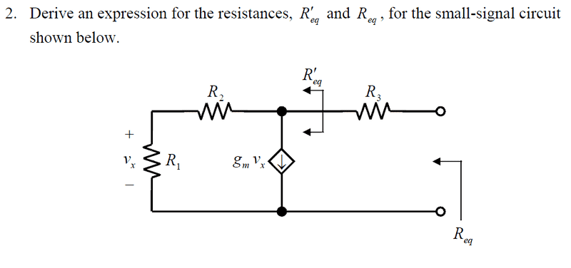

Equilivant Resistance with Source
  • Thread starter Thread starter dhens43
    Resistance Source
The discussion focuses on finding the equivalent resistance (R'eq) in a circuit with multiple resistors. Participants emphasize the importance of understanding the relationship between voltage, current, and resistance to solve the problem effectively. The formula for calculating equivalent resistance in parallel circuits, 1/R1 + 1/R2 + ... + 1/Rn, is mentioned but noted as unhelpful for series circuits. A suggested approach involves placing a voltage source at R'eq to calculate the current delivered into the circuit. Overall, the conversation centers on methods for determining equivalent resistance in complex circuits.
dhens43
See picture
1/R1 + 1/R2 . . . 1/Rn doesn't help you along with series equation
Don't know where to start
Start with finding R'eq. It might help to remember that the ratio of voltage to current is a resistance; if you place a voltage source at R'eq and calculate the current it delivers into the circuit...
