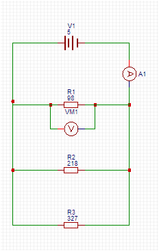

  • #31
CWatters said:
On my meter poor contact at the probes gives an error of a few ohms. I suppose that sort of thing might account for your 13ohm error in 100 =13%. It's harder to explain a 100 ohm error in 200= 50% error??
+ If my component did un-clip the circuit would become broken and no current would flow

I know it's not relevant to my earlier question, however how would I calculate resistance of my circuit at each voltage interval in parallel set up like this : https://gyazo.com/25a70bf570d626ac0c1373184075e77d? using voltage and current? R1=V2/A3, R2=V3/A4, R3=V4/A5 than 1/Rt=1/R1 + 1/R2 = 1/R3?
  • #39
Yes that works.
However if the meters are "ideal" meters then the equivalent resistance of the lot could be calculated as Vm1/A1.

  • #42
Daniel2244 said:
Was meant to write R1=V1/A3, R2=V1/A4, R3=V1/A5
Because I am measuring the resistance at 1v-5v at 1v intervals
If the meters are ideal then all the voltmeters will read the same (VM1 = VM2 = VM3 = VM4 = V1) so both methods will give the same answer.
The resistor values in the circuit are quite low (99 to 327 Ohms) compared to the resistance of most voltmeters (20K to 10M Ohm). So for example 20,000 Ohms in parallel with 327 Ohms = 322.7 Ohms so the volt meters hardly have any effect on the resistance and you can consider them to be ideal.
The internal resistance of an ammeter or DMM on the current range setting can vary. I think most are around 0.02 Ohms (eg they have a 200mV drop at 10A) but some might be more like 1 Ohm ? So for example you have a 1 Ohm meter in series with the 99 Ohm resistor = 100 Ohms. So even a 1 Ohm ammeter should only affect your circuit by 1%. so you can pretty much consider the Ammeters to be ideal as well.

  • #52
Your ammeters don't appear to be placed in series with the resistors that you're measuring the voltage across :confused:
  • #53
Does that really matter? because I am using voltage from power supply over the voltage on the branch
  • #54
It should be okay if the meters are essentially ideal. But we are trying to find the source of your discrepancies, so it would be nice to see the branches handled separately. However, let's see what we can make of the measurements that you took.
What were the V and I readings for these two setups:
Were the current values different? Did you have to adjust the source voltage after moving the ammeter and voltmeter?

  • #55
First: VM1=1v, A1 =3.70 second: VM1=0.94v A1=13.22
  • #56
Don't you find that odd? If the meters were ideal, shouldn't the readings be the same for both setups?
