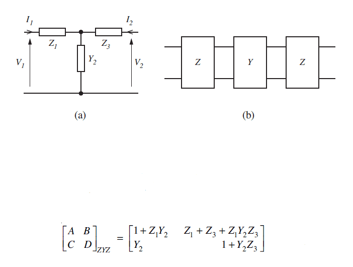

(b) If the line is modeled by the T-circuit of FIGURE 3(b), see if you can estimate the primary line coefficients R, L, G and C. The line is 50 km long.

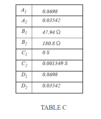

From the table I am using C as 0 + j.001349s = Y2
A as 0.8698 + j 0.03542
so
(1+Z1Y2) = A
(.8698 + .03542 j - 1)/(.001349 j)= Z1
= 26.26 - j644.75
I am using an online calculator for this. I have looked at other posts and my answer is different am I doing something wrong to get Z1. I was then going to use the equation Z1 = 0.5 (R +jωL) x length of line. am I on the right track.

Apart from the fact that Z1 = 26.2565+j96.516 the calculation is correct.
Hi Babadag
Thanks for the help again. You mean they were wrong and mine is correct?
so Z1 = 26.26 - j644.75
0.8698-1=-0.1302; -0.1302/j0.001349=-j0.1302/(j^2.0.001349)=j96.516 it does not?
j0.03542/j0.001349)=26.256
oh
that means Z1 = 26.256
how would I go about getting Z1 = 0.5 (R +jωL)x line length ?
would L be 0?
I am sorry, billyray. Your division it is wrong.
Let’s say you have to divide a+jb by jc (a+jb)/jc=a/jc+b/c=ja/(jxj)c+b/c=b/c-ja/c
a=0.8698-1=-0.1302
b=0.03542
c=0.001349
Then the result will be: b/c=0.03542/0.001349=26.2565;ja/c=-j(-0.1302/0.001349)=+96.516 does not it?
ah ok I see thank you for the time and effort Babadag its most appreciated.
R would then be 26.2565 and L j96.5901 / 2 x pi x 50
would Cs just be j 0.001349 /2x pi x 50 and G = 0
I am a little confused about C as 0 + j.001349s = Y2
Y2 = (G + jωC) x length of line
would g just be 0 and Capacitance be j.001349/2xpix50

Reactance : inductive XL= Lxꞷxlength; capacitive XC=1/(Cxꞷxlength) but Y2=length/Rair+j/XC=Gxlength+jCxꞷxlength.
All these parameters are direct proportional with the length.
Thanks Babadag
so if I use Y2 = (0 + j.001349ꞷ )x length
I can use 0 = G
ꞷ=2xpix50Hertz
and j0.001349/ꞷxlength
=4.294 x 10^6 xlength for capacitance
thanks again for helping
Sorry.G- the shunt conductance- it is not actually the air resistance but the insulator creepage resistance- something about 1-2/10^9 S [S=Siemens=1/ohm]
