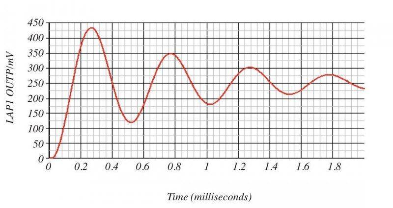

Estimating the damping ratio from the waveform graph
In summary, the damping ratio ζ was estimated to be 0.224. The forced or damped frequency of oscillation was estimated to be 2 kHz. The natural or undamped frequency of oscillation was estimated to be 2001 Hz.
cjs94
From the waveform shown below, estimate
a) the damping ratio ζ (you may compare response with a standard chart);
b) the forced or damped frequency of oscillation; and
c) the natural or undamped frequency of oscillation.
Since the waveform is under damped, I'm attempting to use the logarithmic decrement method, described here: http://en.wikipedia.org/wiki/Logarithmic_decrement

I have estimated the first two peaks from the graph as:
[tex]p_1 = 0.438\text{ V} \text{ at } 0.27\text{ ms}[/tex]
[tex]p_2 = 0.350\text{ V} \text{ at } 0.77\text{ ms}[/tex]

The problem is that I'm not sure I believe the results. I'm trying to verify the results by putting them back into the second order characteristic equation:
[tex]\begin{align}
\text{C.E.} &= s^2 + 2\zeta{\omega}_{n}s + {\omega}_{n}^2\\
&= s^2 + (2 \times 0.0356 \times 2\pi \times f_n)s + (2\pi \times f_n)^2\\
&= s^2 + 895s + 158071624
\end{align}
[/tex]
then simulating that with a Laplace block in PSpice. However, the simulated waveform doesn't match the one above. The frequency is correct, but the damping ratio is too low -- playing about with the numbers, I find I need to increase the damping ratio to approximately ##2.8\zeta## to get the waveform looking correct.
I don't know if there is a problem in my method and the results are wrong, or if my simulation is in error (or possibly both!). Can someone please help?
Thanks,
Chris
I got different results. My fn was about 2009 Hz and my ζ = 0.0974. I estimated fd = 2000 Hz and peak ratio = 1.85.
I can't check your math since you did not define n and σ. You were aware that x = 0 corresponds to 250 mV, right?
I did notice that (my ζ)/(your ζ) was about the number you thought it should be.
I didn't consider ##x(0)##. I guess it makes sense as the wave seems to be settling to 250 mV, but I don't see how it is relevant. As I understand the method, you estimate based on two successive positive peaks, which I have done.
Which peaks did you use and what did you estimate their coordinates to be?
In my calculations I chose the first two consecutive peaks, thus ##n = 1## (I should have been more explicit about that). Why do you say that I haven't defined ##\sigma## though? I did show my working, repeated below:
[tex]\begin{align}
\sigma &= \ln\left(\frac{p_1}{p_2}\right)\\
&= \ln\left(\frac{0.438}{0.35}\right)\\
&= 0.224
\end{align}
[/tex]
Ah! Don't worry, I've figured out where I've gone wrong, helped by your comment about ##x(0)##. I've incorrectly used the absolute peak values, rather than their relative values from ##x(0)##.
Thanks for the help!
Uploading waveform image again, since the link in the original post is now broken and I can't figure out how to edit the post.
