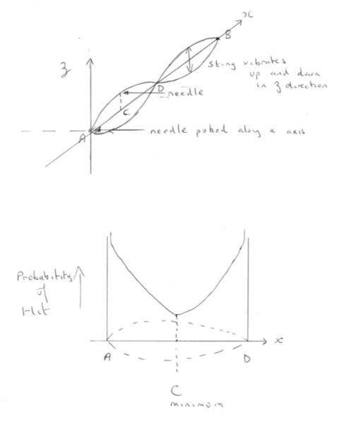

Steve, please don't try to jump the gun. I have been thinking about a suitable form of presentation and will post as promised.
Meanwhile try this.
Visualise a plucked string such as a guitar string.
We know, and can see, the standing wave pattern that is developed.
Now ask yourself this.
If I take a fine needle and poke into the region of vibration what is the variation of probability of hitting the string along the length of the string?
I will address this and also show you that for a quantum situation suprisingly the probability curve is the other way round.
Incidentally 'fuzzy' has nothing to do with quantum probability.
go well
Studio T
Absolutely! That I get.
You are doing fine and I am trying to steer you to how I am thinking so that you can bring it along to what you are trying to say.
So here is the first installment.
In the top sketch I have drawn a 3D representation of our twanged string going away from you from A towards B.
You can see that it is vibrating (up and down ) in first harmonic mode, so there is a node (zero vertical displacement) at A, D and B and an antinode at C and again further along between D and B.
I have also shown our test needle at various points.
At A applied on x-axis at the level of the node.
At C above the x-axis (mean level of string) but within the vibration envelope.
Now since the infinitesimal (point) section of string at A is stationary it is always at A and there is 100% probability that we will hit the string without needle, whatever time we poke it.
A similar situation occurs at D.
But at C the string has furthest to go up and down so spends the least time at any single value (point) of level.
So a random poke with our needle will have to be very lucky to encounter the string ie the probability of encountering the string is a minumum at C.
In the second sketch I have just shown a 2D graph of probability along the x-axis of our needle hitting the string, between A and D
This can be seen to be a cup shaped curve with the minimum half way at C as expected.
This idea of the probability of encountering the string if we suddenly poke in a probe in an ordinary oscillator is equivalent to the idea of the probability of encountering or finding a particle at any particular point in a quantum oscillator, which is for the next installment.
