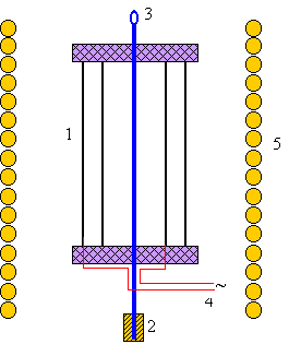

There is well known Graham–Lahoz experiment
G. M. Graham, D. G. Lahoz. Nature, 285, 154, 1980.
where "dispacement current" interreacts with constant magnetic field by Biot-Savart law.
It is OK! But a question appears - what namely force acts on the material of the capacitor??
I was very surprised nobody knows the answer !
Turning on the magnetic field induces a surface current that is up on your picture for one plate and down for the other. This current lasts until it gives a positive charge at the top of one plate and a negative charge at the top of the other plate. The F=qE provides a torque.
It is not true. In Graham-Lahoz experiment magnetic field is constant!
Turning on the magnetic field is not possible!
I am very pardon! I was wrong in understanding this experiment. There is no unusual :D
