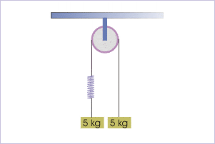

Scenario: a block of mass 5 kg is hanging from a spring from an ideal pulley from one side, the other side supporting a mass of 10 kg through a STRING.
Now, the 10 kg block replaced with a 5 kg block.
In which case would the extension in spring be greater, assuming constant acceleration.
10(g-a)=5(g+a) - kx1
and
5(g+a)-kx2= 5(g-a)
I know the answer is the first case, visualising it(and according to the solution). But I'm not able to prove this mathematically. From my equations I'm getting x1 proportional to (15a-5g) and x2 proportional to 10a and i don't know how these are related.
Thanks for the help :-)

this is the second case.

Let's look at the second case first with the two 5-kg masses. What do you think the acceleration is in this case?
i use the equation 5(g+a)-kx = 5(g-a) to get a = kx/10.

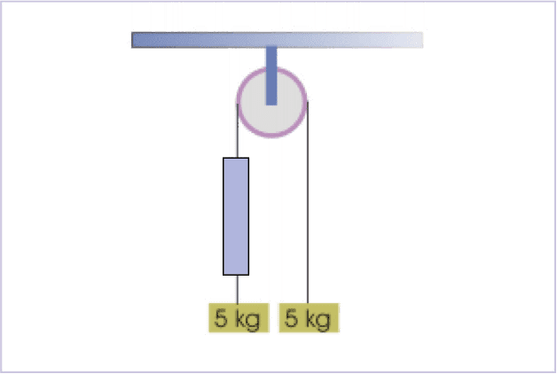

Wherever you got that equation, it does not apply here. Suppose I hid the spring with a piece of cardboard (see figure) so that you are not able to see it. All you see is two equal masses on either side of the pulley. You don't know the spring is there and you assume that the string is continuous behind the cardboard. Which way do you think the pulley will be accelerating under these circumstances? Clockwise or anticlockwise?
wouldn't a be 0 if we assume no spring?
Exactly. It is zero. What is the tension in the left string? What about the right string?
5g in both.
Very good. Now suppose I remove the cardboard and you discover that there is an extended spring behind it. Would anything change? Would the masses all of a sudden accelerate?

Can you draw a force diagram of the left, 10 kg, mass with just a small piece of the string attached to it? Just include part of the string but not the spring. Include, that is, what is showing below the cardboard on the left side of the picture I posted, but with the 10 kg instead of the 5 kg mass. Pretend that you are seeing the mass accelerating down. Can you tell me what forces are acting on it? Remember, you have no idea the spring is there.
