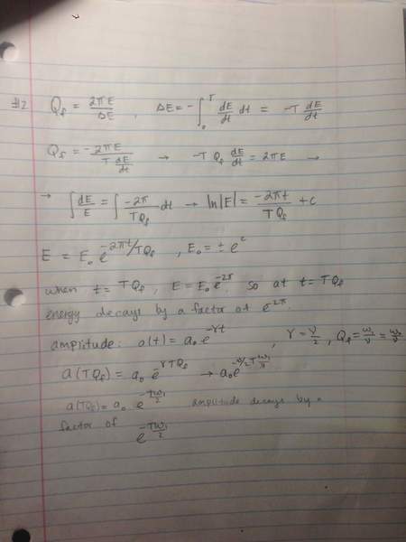

By what factor does the amplitude decay in the time interval (which I had to find).
E: stored energy
γ:damping rate
a: amplitude
t: time
Q: quality factor
T:Period
ω: frequency
Q = 2∏E/(ΔE)
I found the interval to be t=QT
but "one cycle" indicates T=2∏?
So I'm not exactly sure if I got the right answer for the quality factor by which the quality factor decays? I feel like there is supposed to be a numerical answer. Any insights? Did I mess up anywhere or took the wrong approach? Anything will help!
Thanks!
Suppose the amplitude decays by a factor of 2 in a certain interval. What does that mean for the stored energy ?
Vice versa yields your answer without much effort !
[edit] In fact your answer can be made to look more attractive if you realize that ##\omega T = 2\pi## :smile:
It would lose half of it's stored energy?
Nope.
