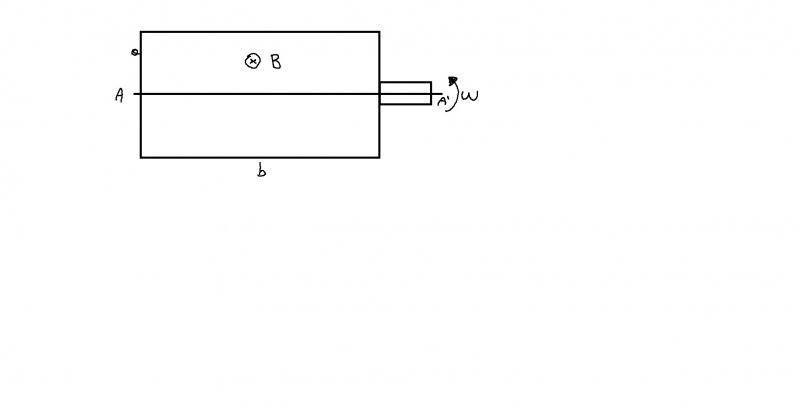

A rectangular coil with a and b sides can rotate around the axis AA' with angular velocity ω. It is in a magnetic field as in figure.
Diagram of a rectangular coil with sides a and b, rotating about axis AA' with angular velocity omega, in a magnetic field B directed into the page (shown as circled cross).
Calculate the flux of B when the coil is orthogonal to the axis AA'. Calculate the [itex]\epsilon_{max}[/itex] and express the position of the coil.
[itex]\epsilon = -\frac{d}{dt} \phi_B[/itex]
The flux when the coil is orthogonal to the axis AA' is 0.
[itex]\phi_B = NBabcos\theta[/itex]
[itex]\theta[/itex] is 90°, so the flux is 0.
Now I calculate the emf.
[itex]\epsilon = -\frac{d}{dt} \phi_B = NBab\omega sin(\omega t)[/itex]
The emf is max when [itex]sin(\theta)[/itex] is 1, so when [itex]\theta[/itex] is 90°.
Is it correct my procedure?
If yes, why emf is maximum when flux is 0?
Since the coil rotates about that axis, it is always orthogonal to it. I assume you mean when the plane of the coil is perpendicular to the surface of the drawing.
Yes.
What matters is not where the emf is maximum but where its rate of change is maximum.
Edit: Oops... I meant flux, not emf, of course.
Yes, sorry, I meant that.
