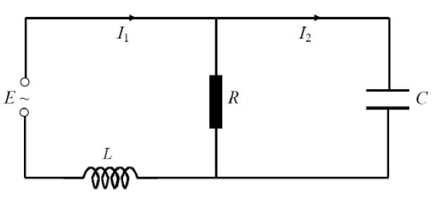

I need to find the currents I1 and I2 in the attached image, but am having some difficulties grasping the concepts. I am given E(t) = 338sin(t) as well as values for R, L and C. I think I know what I need to use but I am not sure how to put it all together
Kirchhoff’s Voltage Law
Kirchhoff's Current Law
I1 = L d2I/dt2 + R dI/dt + I/c = E(t)
I2 = R dI/dt + I/C
I have tried a bunch of things but I don't think any of them are right

What are the values of R, L and C?

These equations are incorrect.
But, you don't have use DEs unless you want a complete time-domain solution (transient+steady state). You only need steady state currents here, so use phasor algebra.

R = 5 Ohms, L = 1 Henry, C = 0.02 Farad
Thanks - unfortunately Lecturer said that we have to use differential equations.
I have tried solving with differential equations to find I(t) - but this doesn't really find the answer
Which course is this assignment from? If it is from ac circuits course, I am sure you don't need DEs at all.

You'll have second order DEs with two variables. It would get very complicated.
The phasor approach will take less than five steps to find the (steady state) currents.
