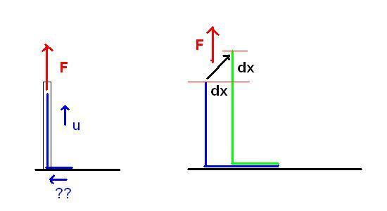

The end of a chain of length L and mass per unit length ρ, which is piled up on a horizontal platform is lifted vertically with a constant velocity u by a variable force F. Find F as a function of height x of the end above platform.
A)ρ(gx+2u^2)
B)ρ(gx+u^2)
C)ρ(2gx+ρu^2)
D)ρ(u^2-gx)
The chain goes up with a constant speed so at any instant the net force should be zero i.e. F=mg. If the height of the end is x, then m=ρx therefore F=ρgx. But there is no such option. :confused:
Any help is appreciated. Thanks!
Think: The part of the chain still on the ground has zero speed. The force has to accelerate new and new pieces to speed u.
ehild
The mass of the chain being pulled up by the variable force is also variable.
ehild
I understand it now but I am unable to form an equation to find F.

ehild said:
Or use energy. The work done when increasing the length by dx is the difference of the initial and final energies.
I have formulated an expression for the work done but not sure how to proceed further. Here's the expression I have reached:
[tex]W=-ρgxdx-\frac{ρu^2dx}{2}[/tex]
The velocity is constant, isn't it? And think: what force you have to use in the first equation.
As for the method concerning change of energy, you have to use dW instead of W and it is the infinitesimal work Fdx when moving the end of the rope up by dx. Fdx=d(PE+KE). And mind the signs. But something is wrong, I do not see what. The two methods give different results.

ehild said:
As for the method concerning change of energy, something is wrong, I do not see what. You have to use dW instead of W and it is the infinitesimal work Fdx when lifting dx length.
Yes, you are right, I need to use dW and I guess I made a sign error. The infinitesimal work should be
[tex]dW=ρgxdx+\frac{ρu^2dx}{2}[/tex]
Substituting dW=Fdx doesn't give me the right answer.
ehild, can you please explain why the energy method doesn't work?
I do not know. But I am inclined to think that the other method can be wrong. There is force also between the two parts of the chain. I asked the other HH-s, no reply yet.
ehild
The work-energy theorem is correct. A mis-application of F=dp/dt yields ρ(gx+u^2), which apparently is the supposedly correct answer. It's not. One has to be extremely careful in applying either F=ma or F=dp/dt to variable mass systems. Do it wrong (which is remarkably easy to do for variable mass systems) and you'll get the wrong answer. As a clue that this approach is wrong, I found an old version of the problem here, http://www.iitk.ac.in/phy/oldfiles/phy102N/Problem_Sheet_6.pdf , question #8. From that page, emphasis mine:

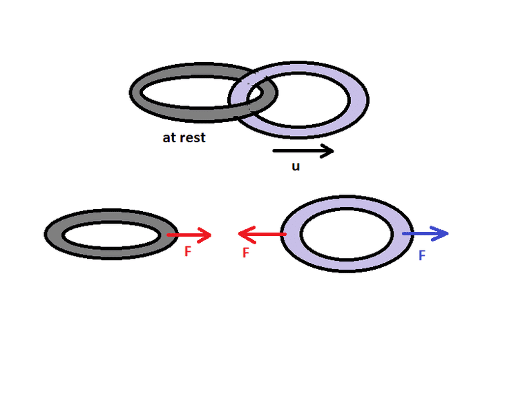

Regarding energy, I suspect that when each link is jerked off the platform, it's like an inelastic collision- causing internal energy to increase. The chain will get warmer!
TSny said:
Regarding energy, I suspect that when each link in jerked off the platform, it's like an inelastic collision- causing internal energy to increase. The chain will get warmer!
But why?
But there is nothing in the problem or solution(s) about the internal working of the "chain". The solution(s) apply just the same to the anchor chain of an aircraft carrier or to a piece of string.
