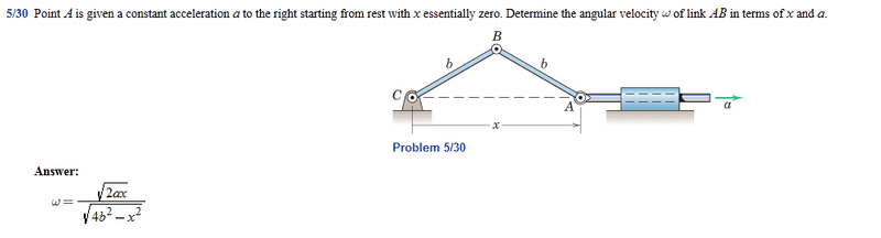

Point A is given a constant acceleration a to the right starting from rest with x essentially zero. Determine the angular velocity w of link AB in terms of x and a.
I have attached an image of the question
w = θ'
α = θ''
Pythagoras and trig
x = 2bcos(θ)
x' = -2bθ'sin(θ)
x'' = -2bθ''sin(θ)-2bθ'2cos(θ)
a = -2bαsin(θ) - 2bw2cos(θ)
I know that bsin(θ) = √b2-x2/4
and I know that bcos(θ) = x/2
Substituting these is
a = -2α√b2-x2/4 - 2w2x/2
After here is where I get stuck. I'm not sure how to deal with the angular acceleration α. I can see that I have part of the final answer (shown in the image) but I'm not sure about the last few steps.
Any help would be appreciated. Thank you

Northbysouth said:
x' = -2bθ'sin(θ)
Maybe you can get θ' from this. But you'll need to find x' in terms of x and a.
Looking at the problem again, I had thought that maybe I could use
x' = V0 + at
where V0 is zero, but this introduces another unknown. Am I over thinking this?
Ahh, wait. I got it. I was overthinking it. I only needed to take the first derivative. From there I can solve for θ'
θ' = -x'/2bsin(θ)
Knowing that a is constant I can use:
x' = v
v2 = v02 + 2ax
where v0 = 0
plug in √2ax for x'
Then i can also see that 2bcos(θ) = √4b2-x2
Cheers for your help TSny
But I still have a negative in my final answer which shouldn't be there...
The signs are going to depend on your choice of positive directions. If you choose counterclockwise as positive ##\omega##, then note that ##\omega = -\dot{\theta}##.
