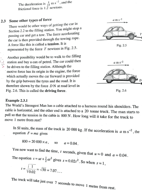

Find the time taken by the truck to move 1 metre

See attached.
kinematics
Unless i am missing something; there is an error with the textbook
It ought to be ,
## t= \sqrt {\dfrac{1}{0.04}}= \sqrt 25 = 5## seconds.

chwala said:
Homework Statement: See attached.
Relevant Equations: kinematics
It ought to be ,
If [itex]u = 0[/itex] then [tex]s = \tfrac12 at^2 \quad \Rightarrow \quad t = \sqrt{\frac{2s}{a}}[/tex] as the textbook has, not [itex]t = \sqrt{s/a}[/itex] as you are suggesting.

Let me take a break! Cheers @pasmith
