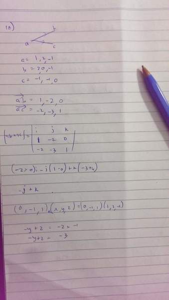

The problem is that I don't get the right answer which is:
2x + y + 7z = -3.
Can you please help me find where I went wrong?

Can you explain what you calculated there?

You calculated the cross-product incorrectly.
##\left( -2 + 0 \right)\hat i \ne 0\hat i ##
##\hat k \left( \ (1) (-3) - (-2)(-2)\ \right)\ne \hat k \left(-3 + 4 \right)##
