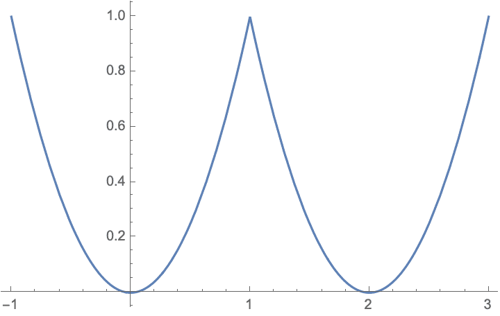

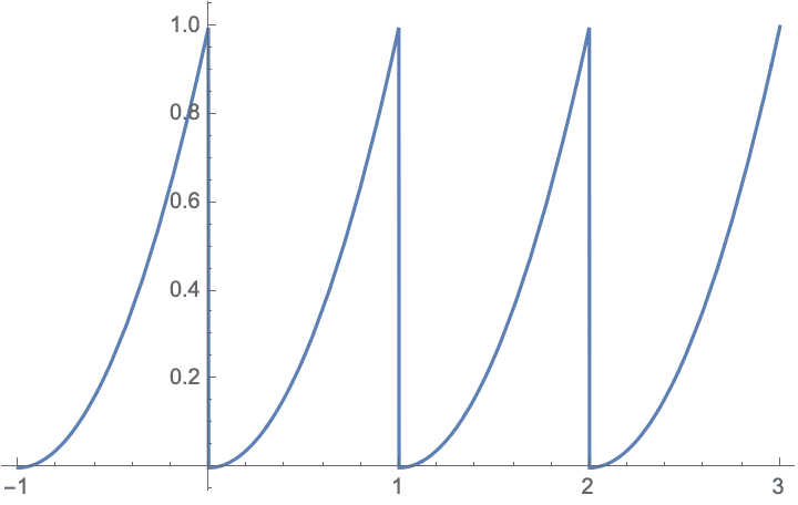

Which of the following are you being asked to find the Fourier series of? If the question asks for the Fourier series of the function you provided in the original post, I'd interpret that as the first one. If, however, you're asked to find the Fourier cosine series, then it's understood that you extend the function so that it's an even function and find the Fourier series of that.
Graph of a periodic sawtooth-like function on the interval from -1 to 3, rising from 0 to 1 along a curve over each unit interval, then dropping back to 0 at each integer.
or
Line graph of a periodic function with minima of 0 at x = 0 and x = 2 and peaks of 1 at x = 1 and x = 3, shown from x = -1 to 3 on axes labelled 0.2 to 1.0.
