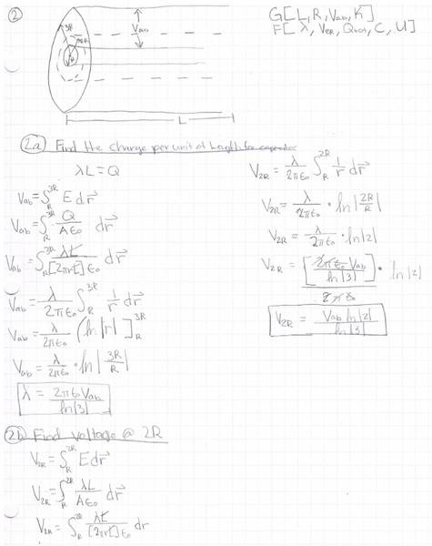

Finding the voltage at a radius of a cylinder
The discussion focuses on calculating the voltage difference between two points in a cylindrical geometry, specifically from radius R to radius 2R. The integral used for this calculation is Vab = ∫ E*dr, where E represents the electric field. The participant is uncertain about the correct limits of integration, debating whether to use R to 2R or 2R to 3R. The correct approach is to set the limits from R to 2R to accurately determine the potential difference as required by the problem statement.

Vab = ∫ E*dr
[/B]
For part (b) I am not sure if I should set the upper and lower bound of the integral from "R" to "2R" or "2R" to "3R". If done so, this would give me V2R = Vab * ln|3R/2R| / ln |3| instead of what is on the image.
The problem is asking you to find the potential difference (i.e. voltage) between a point on the inner cylinder at r = R and a point at r = 2R. What do you think the limits of integration ought to be?
