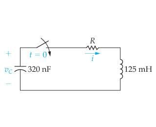

Series RLC circuit schematic: a switch marked t = 0 and resistor R in the top branch, current i shown flowing right, a 320 nF capacitor with voltage vC on the left, and a 125 mH inductor on the right.
In the circuit in the following figure, the resistor is adjusted for critical damping. The initial capacitor voltage is 15 V, and the initial inductor current is 6 mA and R=1250 ohms
Find vC(t) for t≥0.
Express your answer in terms of t, where t is in milliseconds.
i=c*dv/dt
the only part of this problem i am not getting is solving for the constants with the given initial conditions... the 2 roots to the differential equation are -5000. so:
v(t)=C_1*e^(-5000t)+C_2*t*e^(-5000t)
and
dv/dt [at t=0+]=-5000*C_1+C_2=i/c=(6*10^-3)A/(320*10^-9 F)=18750 volts/s
v(0)=C_1=15V
so C_2 -5000*15=18750...C_2=93750
but apparently C_2 is actually equal to 56250...If the equation was C_2-5000*15=-18750, then i would get 56250...where am i going wrong?
As the charge flows away from the capacitor, I=-dQ/dt= - C dV/dt.
ehild
