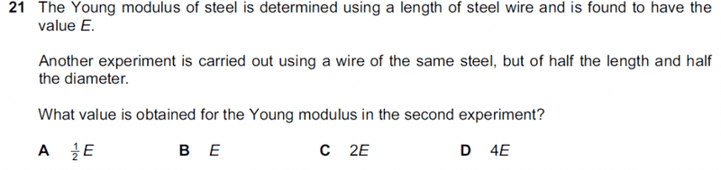

Why is My Young's Modulus Calculation Giving a Different Result?
In summary, the equation states that the Young's modulus, E, is equal to the product of the wire's thickness, F, and the distance between the wires, A, divided by the wire's length, L.
toforfiltum
341
E= (F/A) x (L/ΔL)
I know that since the material is the same, the Young modulus should be the same. However, when I try to find the ratio of the second wire to the first, I get the answer C. For the first wire, E= 4FL / d2Δl, since A = d2/4.
For the second wire, the value of E I obtain is F x ½L / (d2/16) x Δl , which is twice the first value. I can't see what's wrong with my working. Can someone point it out?
This is a conceptual question, so we know for a particular material at a certain temperature Young's modulus will be a constant. Using the above equation we see that area does not reduce linearly so you're probably wondering how do I compare a thicker wire to a thinner one. Remember that to get the same ratio of change in length from original length in the thinner wire will require less force. So while your area is a quarter of the size of the original wire, the force needed is also reduced.
Oh I see, so from the information given in the question above, there's no way of obtaining the same value of E as the first wire without knowing the change in the value of F is it?
Yes, its not meant to be solved numerically.
Ok, thanks.
