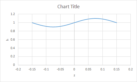

Hi,
I have some points say, 100 points which come from a periodic tube profile, i.e., (z,r), where z and r are the axial and radial coordinates, respectively.
Now, I need to calculate the first derivative at each point.
Could you please help me in this regard?
Cheers

Hi, I have given the profile below
I want to calculate dh/dz. Some data are below:
It looks to me like your data do not match your graph...
But in any case, are you aware of the definition of the derivative? Or implementations in discrete datasets?
One way to do it is:
[tex]h'(z) =\frac{h(z+1)-h(z-1)}{2z}[/tex]
Okay, LaTeX isn't working for me tonight... In clear text:
Note from Mark44: It's fixed now @Berkman -- there was an extra brace that I removed.
h'(z) = ( h(z+1) - h(z-1) ) / 2z
Where 2z is the distance between the 2 bracketing datapoints (in the units of z). Does that make sense?

Numeric derivatives are notoriously bad, so take your results with a grain of salt. A better approach would be to attempt to fit your data to a sinusoidal function. Then get your derivatives from that.
