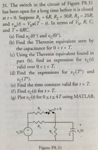

vc(t) = vc(∞) + [vc(0+) - vc(∞)]*e-t/τ (Voltage in a driven RC circuit)
τ = RC (time constant for an RC circuit)
I'm pretty shaky with these sorts of problems and am quite unconfident of my work here. Step functions tend to confuse me and I'm not quite certain I interpreted this one right- I understand it to mean Vin(t) = V0 when t ≤ τ. Also, my time constant appears to be inconsistent with the one given in the problem, but I'm not sure if it's supposed to be the same thing.
Would appreciate some clarification.
