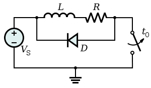

So in an application like this:
The coil of the motor will, by Lenz's Law, induce a very large negative voltage across its terminals. Would this voltage be very negative at the left terminal of the inductor and very positive at the right? In this way the diode will conduct, but the negative voltage in this case would be directly connected to the power supply.

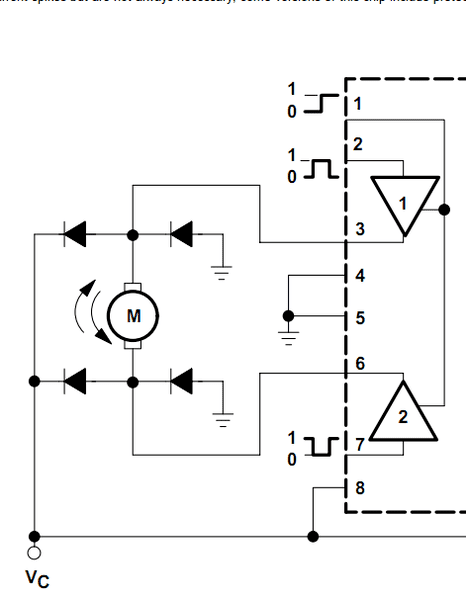

Also, how are the flyback diodes in this way utilized[L293 - H Bridge IC]:
It seems that the two left diodes will always be reversed biased, but what about the right-side two? Why are the left-side diodes even present if they are always reversed bias? It seems that the large negative voltage would forward bias one of the diodes to the right (whichever terminal is induced to a large negative potential), but what benefit does that have? Also, current flow back into the H-Bridge circuit does not appear very practical.
Perhaps I am looking at this all wrong.
EDIT: Given this situation:
-Current flow from top to bottom
-Pin 3 and pin 6 open circuited (transistor base = 0V) to turn off the motor
Is it that a a positive voltage will be induced at the motor's "bottom" terminal and a negative voltage induced at the motor's "top" terminal? In this way, it seems that current would flow from the top diode from ground through the motor and then through the bottom left diode back into the source .. is that practical? How is this current limited? Current through a diode is unrestricted.
Sometimes these diodes are called clamp diodes, and yes you are correct, in the first illustration a large negative voltage is created when the switch is opened. The clamp diode is normally reversed biased but when there is an opposite current flowing it will protect the power supply as well as other components in the circuit. The negative voltage will be connected to the power supply but since the switch is opened on the positive side, no current will flow. The second illustration is a bit more confusing. There are two scenarios for where the extreme potential will be. Normally all the diodes are always going to be reversed biased but let's say the voltage collapses in the motor and there is an extreme negative voltage induced on the bottom terminal of the motor. In this case current will actually flow out of ground and through the now correctly biased diode on the bottom right and current will flow out of the top terminal of the motor into the top left diode. The other two diodes will be used the same way if the motor stopped after spinning the other way. This setup protects the chip no matter what situation.
I believe this is right but I am not certain by any means. It would be nice if someone else could re-assure my thoughts but I hope this helped, and btw if you don't mind could I ask what you are trying to build? Or is this all out of curiosity?

I think there's a misconception about inductance.
Recall Lenz's law - induced voltage opposes the change in current(well actually flux, but flux and current are in proportion)
So the voltage that gets 'induced' when switch opens is not necessarily large.
Voltage induced will be whatever is necessary to maintain current. No more than that.
In your top figure that'd be (I X R) + diode drop. Is that necessarily large?
In your second figure, the motor can return current to the supply by producing voltage equal to (Vc + two diode drops), thereby maintaining current.
Regardless which end of motor goes negative, there's a diode on each end of the motor for conduction to either Vc or common.
Does that help?

I meant to correct that first line. I meant to say a "large" induced voltage when the diode was not in place as it is.
The voltage at the left terminal would be Vs and the voltage at the right would be Va + (I x R) + Vf, right? It makes sense now. (i.e. (IxR) + Vf voltage induced across the inductor). Also, is this current of the exact same magnitude that it was (for a moment) prior to switching? If that is the case, and the current was significantly large, then the voltage may potentially be quite large as well at the right terminal ( IxR ).

Sure it's practical, it's not the diodes that limit the current it's Lenz's Law.
Lenz dictates that initial current will be whatever was flowing through the motor and of course it'll decay as motor's inductive energy is returned to the source, and some of that energy is dissipated in circuit resistances..
So current just swaps from the driver transistors inside your logic block to the diodes that are in parallel with them, and decays rapidly.

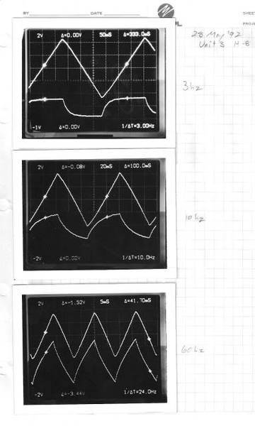

It is very interesting to connect anosciloscope to a transformer winding, exciting the core with non-sinusoids and observe another windng's voltage .
That cements in your mind what those DE's are saying.
Here's a primitive transformer with non-laminated core excited by triangle wave current at three different frequencies.
